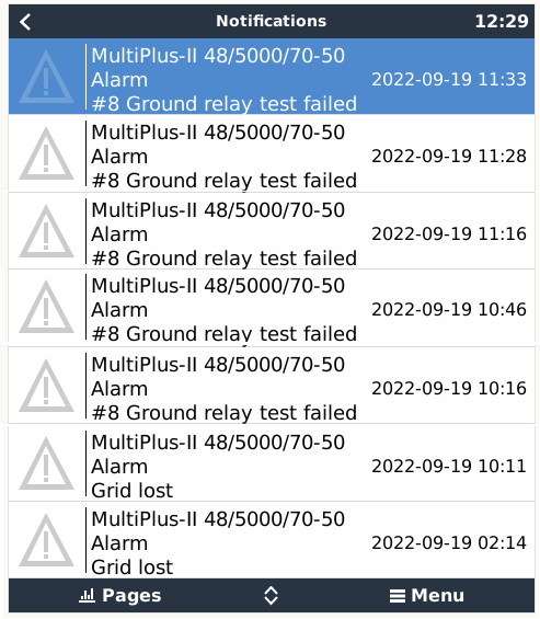

Somewhat related, hence jumping on this thread
Had LS end, followed by inverter trip
Very low grid voltage:
This error:
Are those likely related?
Or do I have to go hunting for more earthing faults?
Edit: sorry, I see now this is probably the wrong subforum for this post.

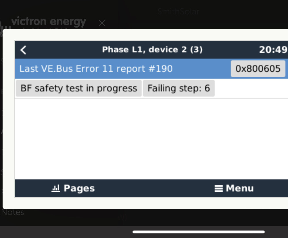

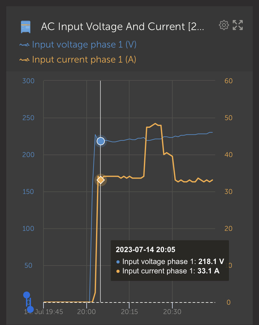

The voltage looks ok…
Error 11 is there, with steps to test.
Also found this …
And this … mine was weird, 8 am AFTER LS started … my suspicion on the end was the panels and their wiring.

Step 6 means: AC1RMS > 100V while only K1 closed.
To understand the relay notation, it is laid out like this:
Live ---------- K1 -------+------------- K2 ------------> Inverter/AC-out
                          V
                    Measure here
Neutral ------- K3 -------+------------- K4 ------------>
K1 is closed and everything else is open. That means there should be no voltage at the measurement point, yet there is more than 100V. K3 is probably faulty. Or as in TTT’s case, some sort of radio noise causes a ghost voltage reading.
Ghost … yes, I concur with that. I did measure in the end, accidentally, a “radio noise” voltage on 1 set of spare wires in the combiner box … not forgetting the teeny doubt floating around in the back of my mind around the earthing of said arrays at that time.
