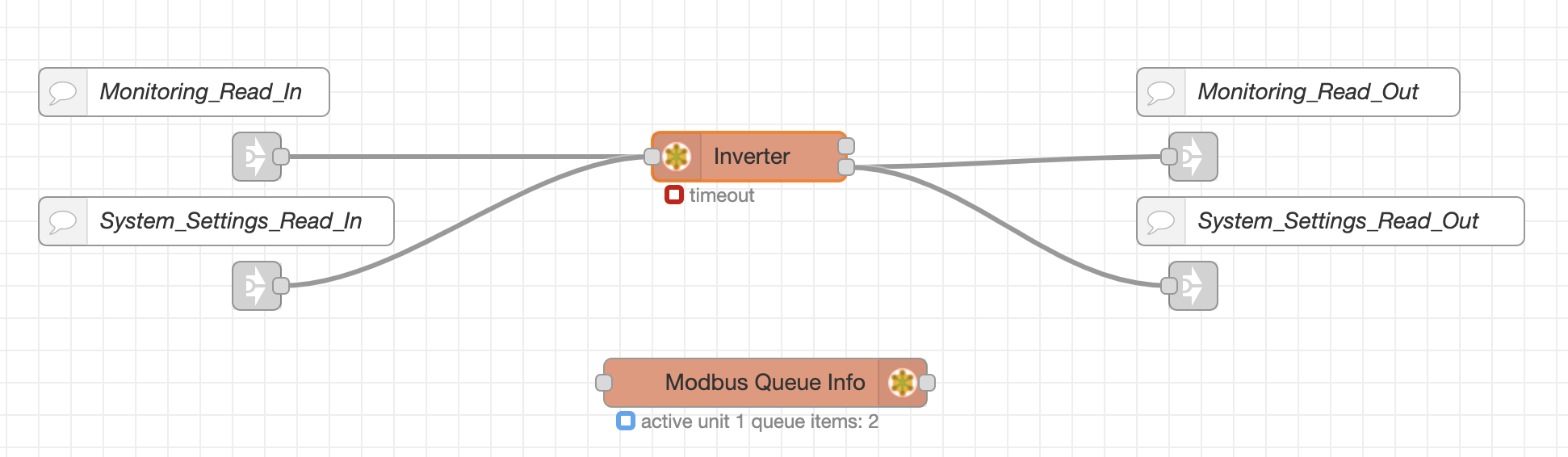

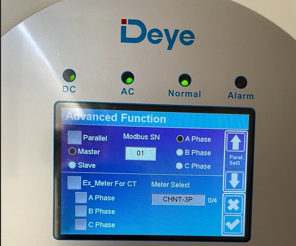

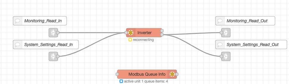

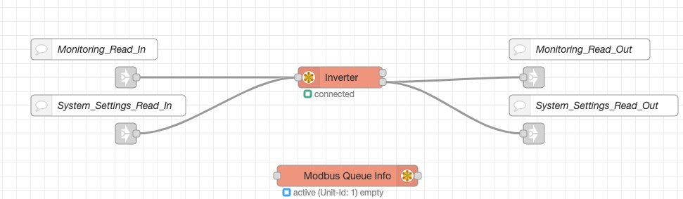

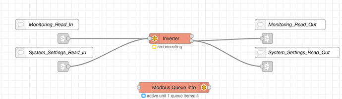

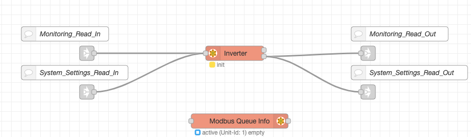

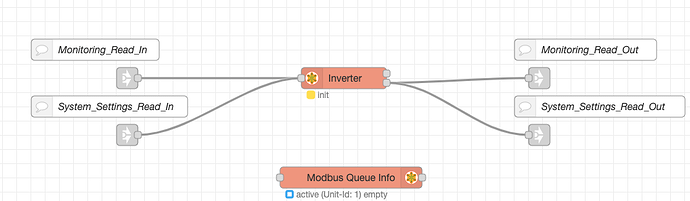

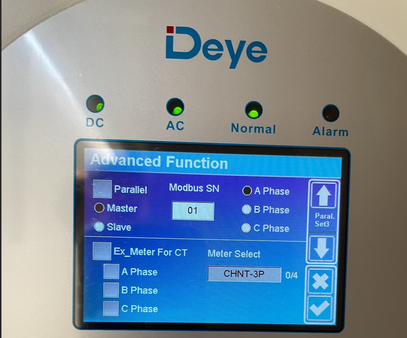

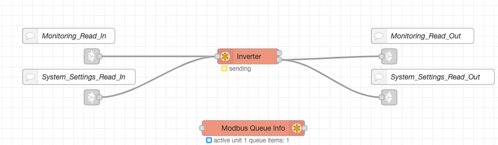

ok cool, thanks for getting back to me. someone also mentioned that they had a firmware update on their Sunsynk inverter and the modbus ID changed to 00 they said that they changed it to 01 and that resolved some of their issues. It’s under advanced settings. I have a Deye 8KW inverter and my ID also changed to 00 after they did a firmware update last week. I did change it in my settings however i get the same issue. it just keeps flipping between “active” “initialise” “init” “Opened” “connected” “queing” “sending” and “reconnecting”. I’m running Node-Red in homeassistant and I’ve tried so many different settings and no luck. The only thing i haven’t managed to do is change the permissions on the /dev/ttyUSB0 i’m not sure if that’s the issue because if i type it out in terminal i get access denied.

The first step is to try and debug within nodered itself. Add a debug node and check what data is being sent and received.

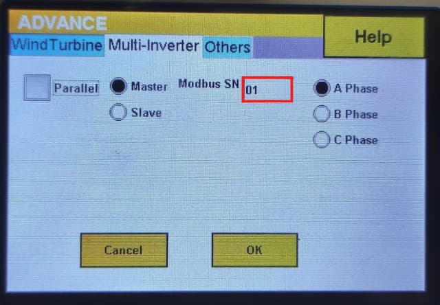

I did try addresses 0-255, seems SunSynk only responds to the broadcast address 0.
EDIT:
You can change SunSynk modbus ID from 0 (broadcast) in Advanced->Multi-Inverter

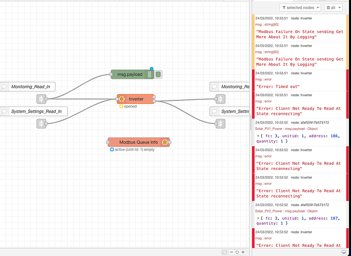

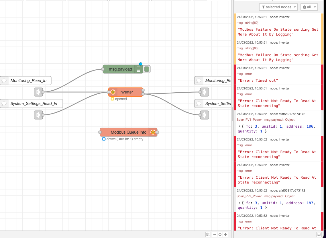

Hi there must be some HW error with the device connecting to the inverter. I’ve tried everything as mentioned in the post above mentioned by @Vassen and no luck. My MQTT connects but the Inverter just keeps switching between connected, queueing, timeout, reconnecting, initialise, init, opened. Like i said i tried 2 different USB adapters and also 2 different RPI’s and the same thing happens.
the debug just shows this the whole time.
24/03/2022, 10:11:20node: Invertermsg : error
“Error: Client Not Ready To Read At State reconnecting”
24/03/2022, 10:11:21node: Invertermsg : error
“Error: Client Not Ready To Read At State init”
I also added a debug node to the inverter and it says the following below
24/03/2022, 10:50:13node: Invertermsg : error
24/03/2022, 10:50:13node: afaf55917b573172Solar_PV1_Power : msg.payload : Object
{ fc: 3, unitid: 1, address: 186, quantity: 1 }
24/03/2022, 10:50:13node: afaf55917b573172Solar_PV2_Power : msg.payload : Object
{ fc: 3, unitid: 1, address: 187, quantity: 1 }
24/03/2022, 10:50:14node: Invertermsg : error
24/03/2022, 10:50:14node: afaf55917b573172battery_output_current : msg.payload : Object
{ fc: 3, unitid: 1, address: 191, quantity: 1 }
24/03/2022, 10:50:14node: afaf55917b573172Solar_PV1_Amps : msg.payload : Object
{ fc: 3, unitid: 1, address: 110, quantity: 1 }
24/03/2022, 10:50:15node: Invertermsg : error
24/03/2022, 10:50:15node: afaf55917b573172Solar_PV2_Amps : msg.payload : Object
{ fc: 3, unitid: 1, address: 112, quantity: 1 }
24/03/2022, 10:50:15node: afaf55917b573172Solar_PV_Day : msg.payload : Object
{ fc: 3, unitid: 1, address: 108, quantity: 1 }
24/03/2022, 10:50:16node: Invertermsg : error
24/03/2022, 10:50:16node: afaf55917b573172battery_soc : msg.payload : Object
{ fc: 3, unitid: 1, address: 184, quantity: 1 }
24/03/2022, 10:50:16node: afaf55917b573172grid_frequency : msg.payload : Object
{ fc: 3, unitid: 1, address: 79, quantity: 1 }
24/03/2022, 10:50:17node: Invertermsg : error
“Error: Client Not Ready To Read At State opened”
24/03/2022, 10:50:17node: afaf55917b573172voltage_inverter : msg.payload : Object
{ fc: 3, unitid: 1, address: 154, quantity: 1 }
24/03/2022, 10:50:17node: afaf55917b573172voltage_grid : msg.payload : Object
{ fc: 3, unitid: 1, address: 150, quantity: 1 }
24/03/2022, 10:50:18node: afaf55917b573172battery_volt : msg.payload : Object
{ fc: 3, unitid: 1, address: 183, quantity: 1 }
24/03/2022, 10:50:18node: afaf55917b573172battery_charge_volts : msg.payload : Object
{ fc: 3, unitid: 1, address: 312, quantity: 1 }
24/03/2022, 10:50:18node: Invertermsg : string[60]

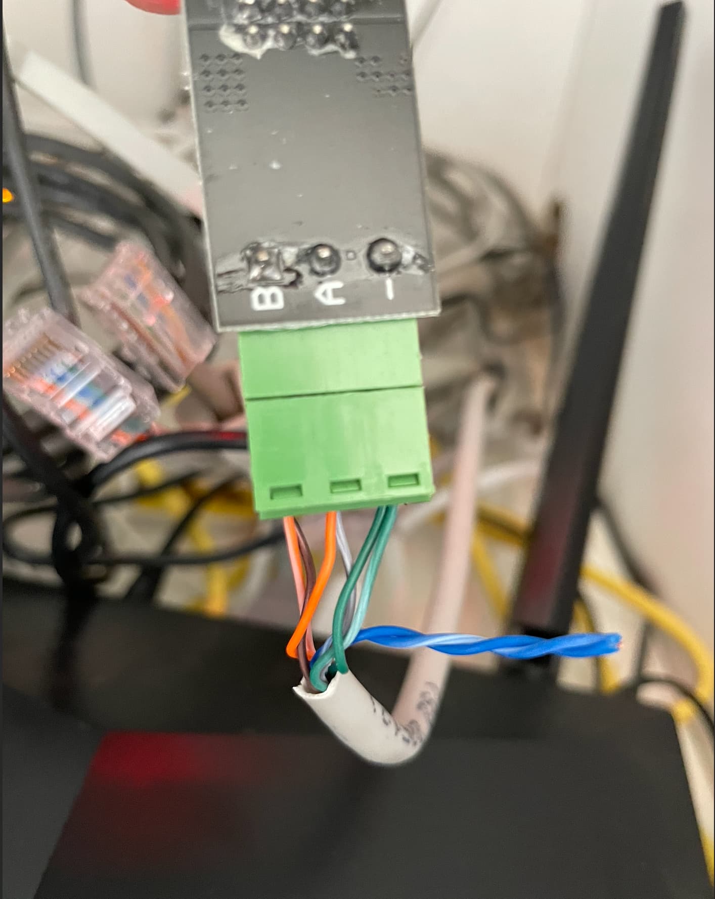

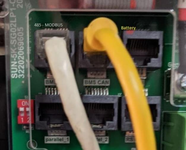

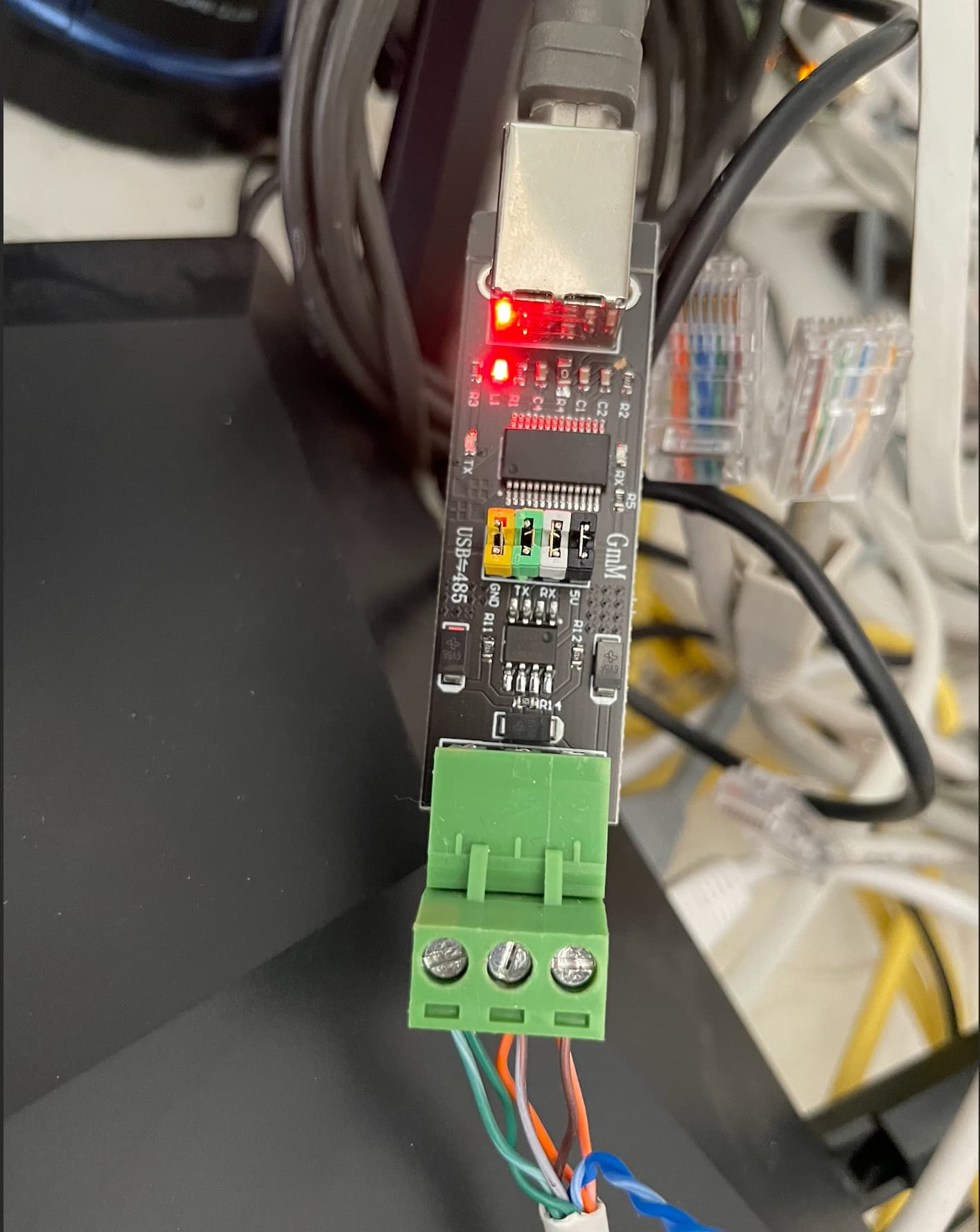

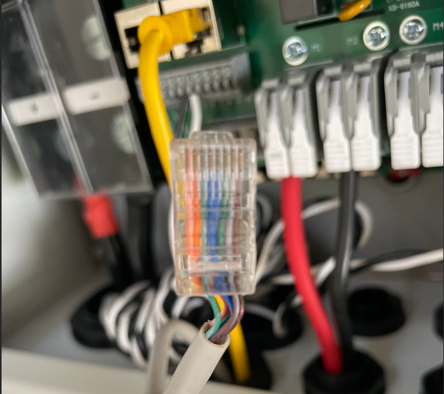

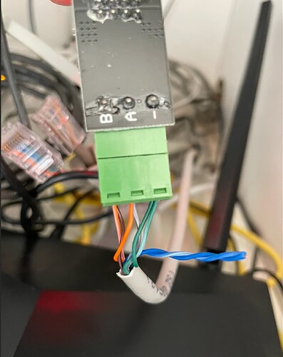

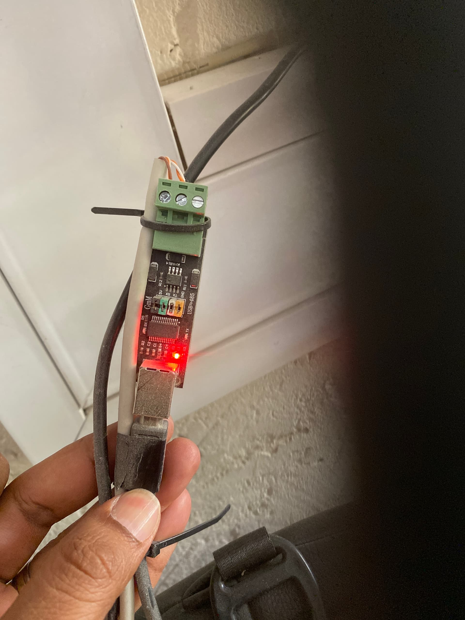

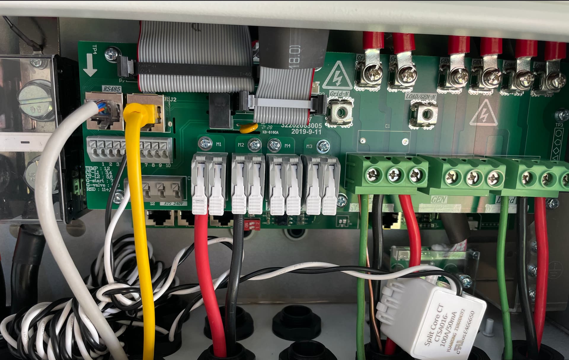

question on the network cable - If i take a normal cat 5e cable and cut the one end off and connect it to the USB as per the diagrams mentioned in the forum will it work or do i have to re-crimp the RJ45 side?
This seems like you’re having EXACTLY the same issue I did - just not getting a response at all from the inverter.
seems like we are. I thought i would attach the diagrams of how I’ve wired mine up. Maybe the network cable is not correct on the RJ45 side. Either way I’m stumped and can’t get it to work.
I just used the 2 connectors for the rj45. Didn’t connect the ground. You can use a standard rj45. Don’t see why it wouldn’t work. Just make sure the correct pairs are used.
thanks, I tried with and without the GRND. I also just tried with a single cable still doesn’t work.
Dit you try swapping them?
let me try that
tried that, no luck
