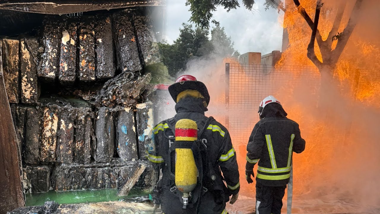

Battery Energy Storage Fire in South Africa
Interesting. In one of the pictures published in the MyBroadband article, you see a couple of guys in high-visibility jackets marked Rhino Energy. If you click around a bit, they do seem to like Huawei solar inverters in their installs. Not much info on who made the battery though… which is what I really wanted to know :slight_smile:
Took this away from your post Plonk …
O, also took this away from the fire …
To switch off a Lifepo4 battery, maybe I must consider putting the fuses “outside” where one can get to them without having to get close to the flames … must ponder on this some more.

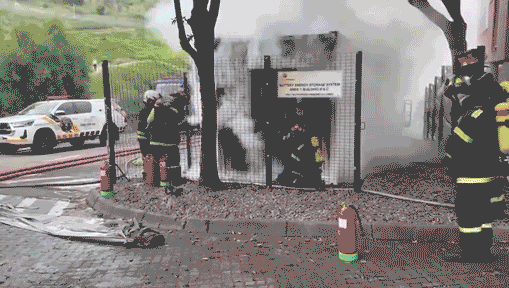

The impact of the specialised extinguishers does not appear as dramatic as the mybb article quotations suggest. From the manufacturer of the extinguishers own video footage it seems that copious amounts of water played a very significant role.
Proper protective gear and at least some training and exposure to firefighting are clearly also prerequisites. If you do not have good access to the cells, you are probably just as likely to succeed with magic beans, as opposed to the fire running out of fuel.
(can’t upload video, so chose some moments and converted to gif).
EDIT: simplified single gif showing sequence
Moment door is opened and specialised extinguishers are sprayed to interior of container:
For a while all appears well, until it doesn’t:
Water and specialised extinguishers used to control flames:
BatFire_CKloof
full video
by all reports no injuries reported during this incident (one firefighter did temporarily lose his helmet with the flashover…)
