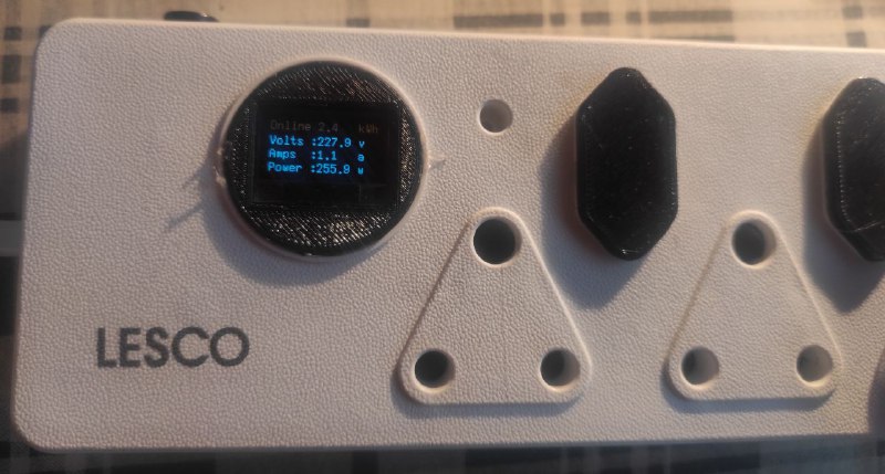

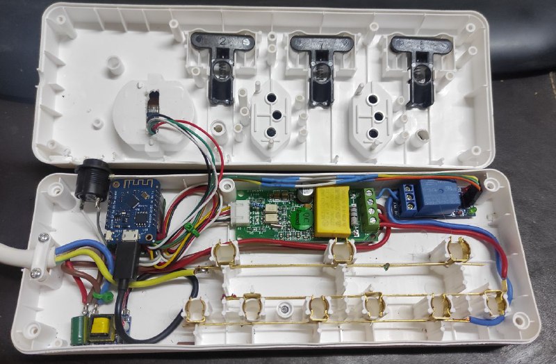

The multiplug Energy Monitor - Only transmit the data via MQTT ( I didnt want the hassle of opening the device to have access to the SD card and battery and also space was a bit of a problem but you have a OLED that displays the data and while I was at it I also added a relay that you can setup for remote control or current control.
I used a Lesco Multiplug ( Think I got it from Builders M) as it had quite some space

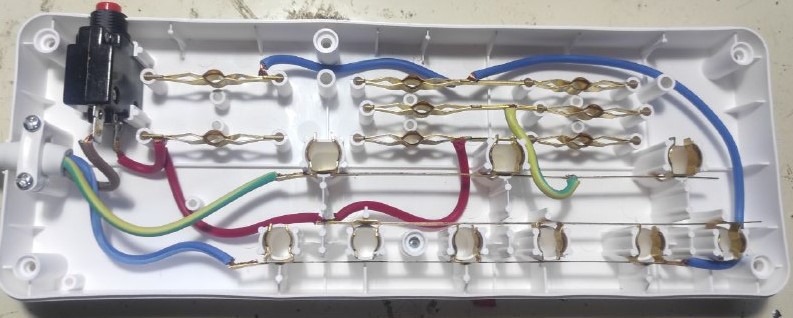

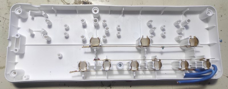

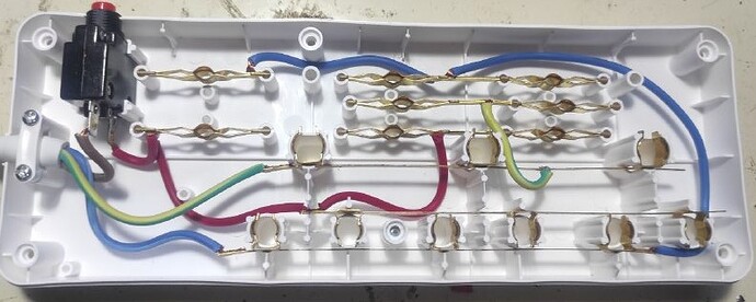

Stripped all the bits and pieces out

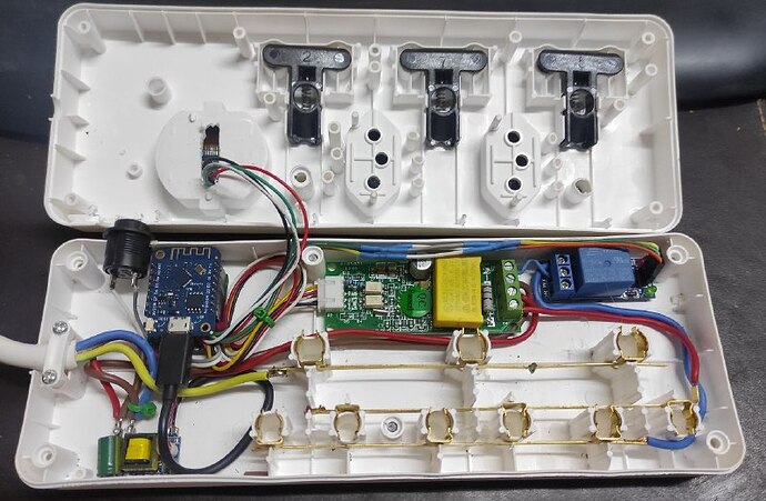

Then proceeded to add the hardware
There was quite a bit of solder work but the got it all locked in.

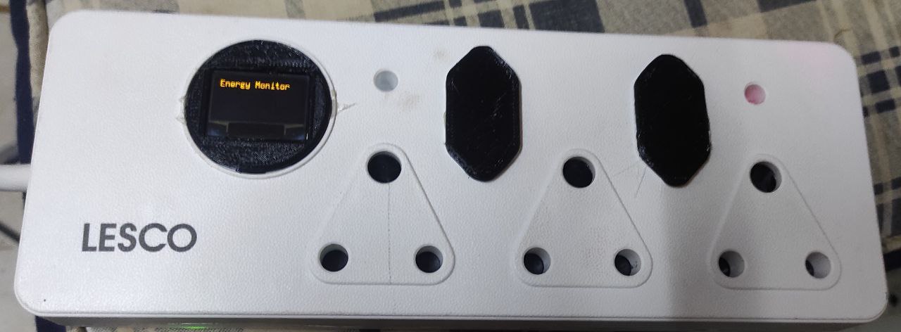

3d Printer came in handy to print the covers and some data on the display

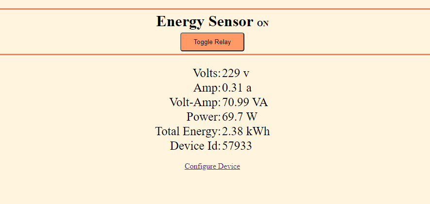

While I was at it I decided to have a small web interface as well
You can setup the Wifi Connection , set a limit to the current draw - should it be too high it will switch off and keep track of the running kwh meter.
It will also send the data to the MQTT server where I then log it as I need to. Personally I prefer Influx Db with Grafana for data logging.
All and all it works well and is use full it you quickly want to have a look at the consumption of a device.

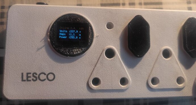

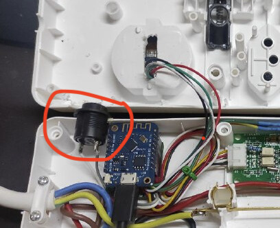

What does this do?
It is a multi control button.
Short press - cycle the Oled between Current values , Max Values and Device status ( Ip Address extr.)
Long Press (+2 s) Toggles the relay
Loooong Press (+15s) resets the device to default
The ap mode is password protected so if you forget the Ap Wifi Password you can reset the device to default. Also the settings menu is password protected so if someone opens the Local address they will see the data but can not alter the settings.
Then if the device times out on the Ap mode and have not connected to the network it will switch off all the online functions and only display the data on the Oled. A short press will activate Ap mode so that you can configure the device.

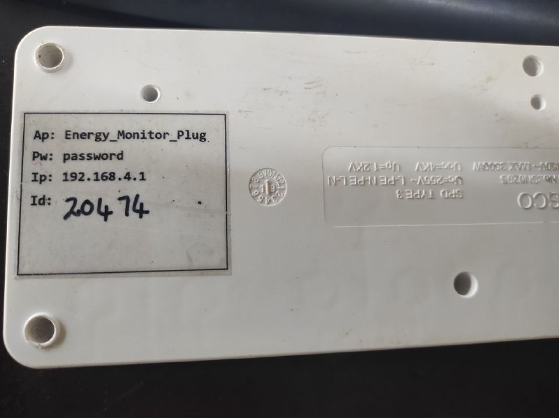

Last thing was just to place a Sticker at the back should I forget the default pass word ( You also need to change that on startup)
