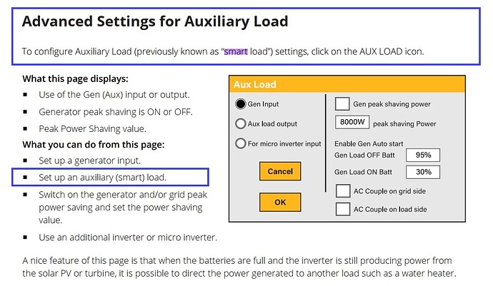

At present one 8kW Sunsynk with one string [10x415 pv and 10.4kW batteries] are more than enough to carry the business through the day and the essential loads [CCTV, alarm, floodlights, fridges] during the night - it is a hybrid system which adresses the rainy season so utility usually is available. Now we will add a geyser and a few aircons which will exceed the inverters capacity yet we anticipate to add about 30 panels…. in short, will I have to add an inverter in parallel or is there a way to compensate with the panels in Auxillary Mode as on image?
EDIT: I was advised to get a second inverter, increase panels and for now keep the batteries as they are due to the fact that daytime load will increase drastic yet night time will stay more or less the same and can be augmented with grid power if need be

Your 8kW inverter is still an 8kW inverter, no matter how many panels you have on the roof. That’s how much power it can provide continually. It may well continue to be adequate at night, but may not be during the day. So either it will trip when demand on the backed up side exceeds the 8kW, or will send what it can to the non-backed up circuits, and those circuits will draw from the grid to make up the difference.
A second inverter will give you 16kW of solar power (from panels or retrieved from batteries) at any one time. You will service a lot more of your load and reduce what you draw from the grid.
Tx Bobster - as you say, for 16kw I need two 8kw inverters, the crucial link in the powerchain - sometimes my lack of logic baffles me :see_no_evil_monkey:
