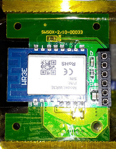

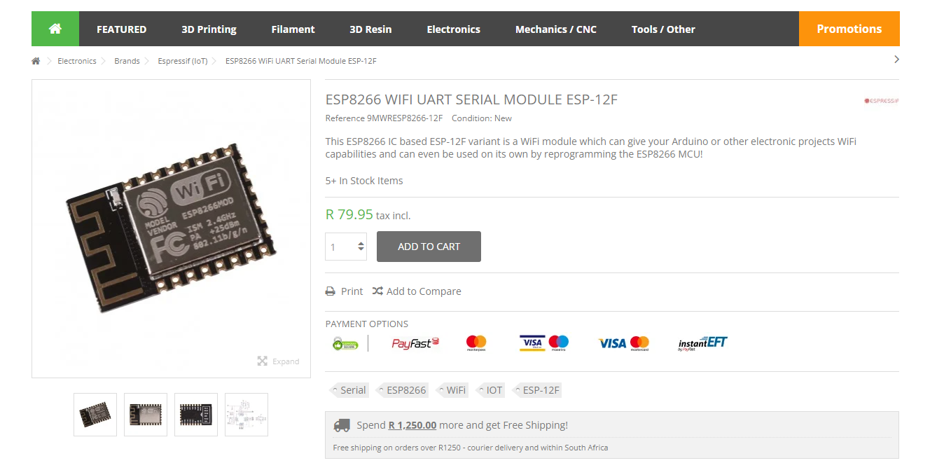

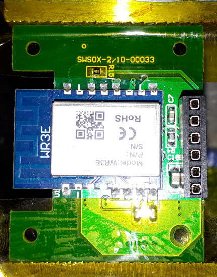

if you feel like playing with your soldering iron you should be able to replace the WR3E with an ESP-12F if you want Tasmota. (now seemingly inactive member @gbyleveldt did the hard work and posted the instructions on MyBB). Even I managed to do this with an Astute Isolator (although I did cheat and use a cheapish Adendorff soldering station with a hot air gun).

use some Kapton tape to mask off the surface mount capacitors and resistors near the chip when desoldering - should help prevent going from “hey look at me, I desoldered a chip like some hollywood bomb tech”…to couple of seconds later… “oh F#%&! [poop] … what is that tiny shiny rectangle and where does it go???”
I also sommer used a bench vice to lightly hold the PCB since I have not yet evolved to have more than two hands.
If new to desoldering - grab any old PCB that is no longer needed and practice on that - don’t be too hasty… my first attempt I tried the soldering iron and oodles of solder everywhere method but struggled to get even heat distribution and ended up pulling a pad of the PCB :flushed:. Rather buy/borrow/steal a hot air station…
Remember to do the power calibration once the chip is replaced and flashed.

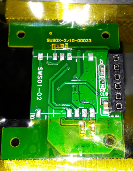

Original Chip (can see the yellow Kapton tape)

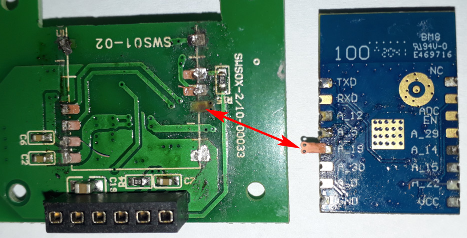

Chip removed (pic was taken before using braid to clean off the old solder from the pads)

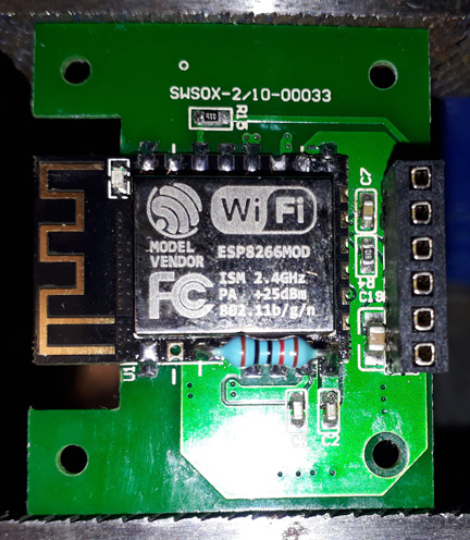

ESP-12 on board (the 0805 SMD resistor soldering is very fiddely and my solder joints will make @Richard_Mackay and @_a_a_a cry :wink: but it still works).
Oh yes, if not feeling like especially the smd soldering there is apparently an ESP-12 (12S) varaint with the pins already pulled high/low - see further in the mybb thread - and three posts down. The 12S is however not that easy to find locally
All the joints I can see looks better than what it had from the factory. :+1:
This one?
Now I can’t get the Lexington radio advert out of my head, that you very much! But, yes, that’s the one… :slightly_smiling_face:

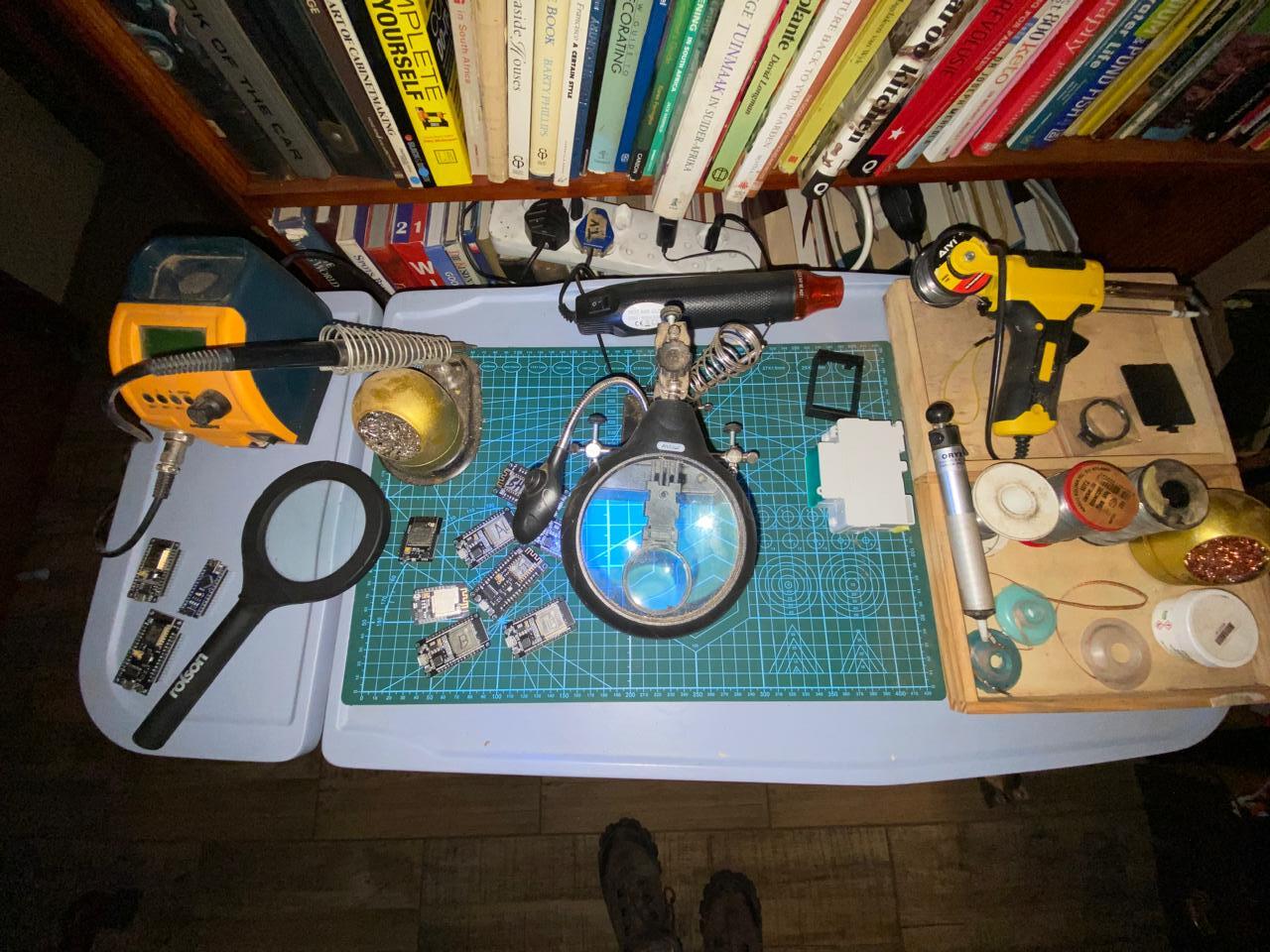

Operation table ready for action.

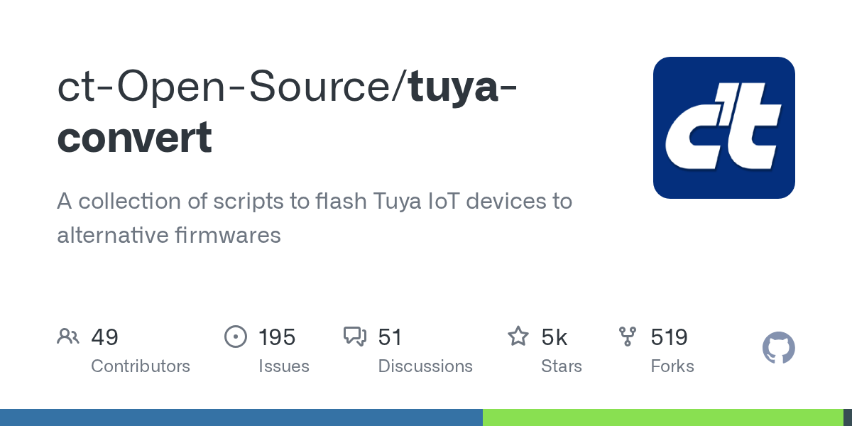

Hi Eben, from what i could gather, when they started off, you could choose from a veriaty of chips, including the ESP8266. I will leave the Github link below as well as two paragraphs from this article. I think I have one with an ESP chip but need to remove it from operation to see for sure.
I will convert my spare unit and then replace one and remove the next till I am done.
A Chinese company named Tuya offers a free-to-brand turnkey smart home solution to anyone. Using their offer is dead-simple, since everything can be done by clicking through the Tuya web page, from choosing your pre-designed products or pre-programmed wifi-modules (mostly ESP8266) to building your own app. In the end, this has resulted in as they claim over 11 000 devices ‘made’ by over 10 000 vendors using Tuyas firmware and cloud services.
Unfortunately many devices have already been shipping with the new patched firmware, evident by a PSK ID beginning with 02 in smarthack-psk.log. There is no workaround at this time. Additionally, manufacturers have been silently switching from the ESP82xx based modules to other chipsets, making it impossible to install alternative ESP firmware on these devices.

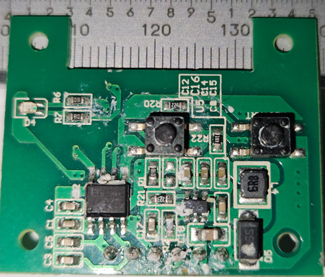

this is the flip side from an Astute Isolator (don’t know if the DIN mount controller is identical). Don’t think heating from the bottom is an option :slightly_smiling_face:
TIFIFY :wink:
