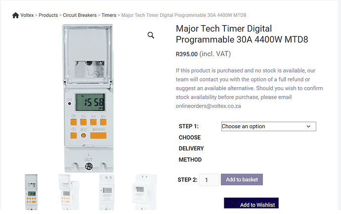

There is really nice electronic timers available from most electrical wholesalers at under R400 and the CBI asutes from builders for about 550 and then the CBI electronic timers for Roughly R700. CBI astude allows for monitoring and changes made over your wifi network, while the others needs someone to change the settings manually.

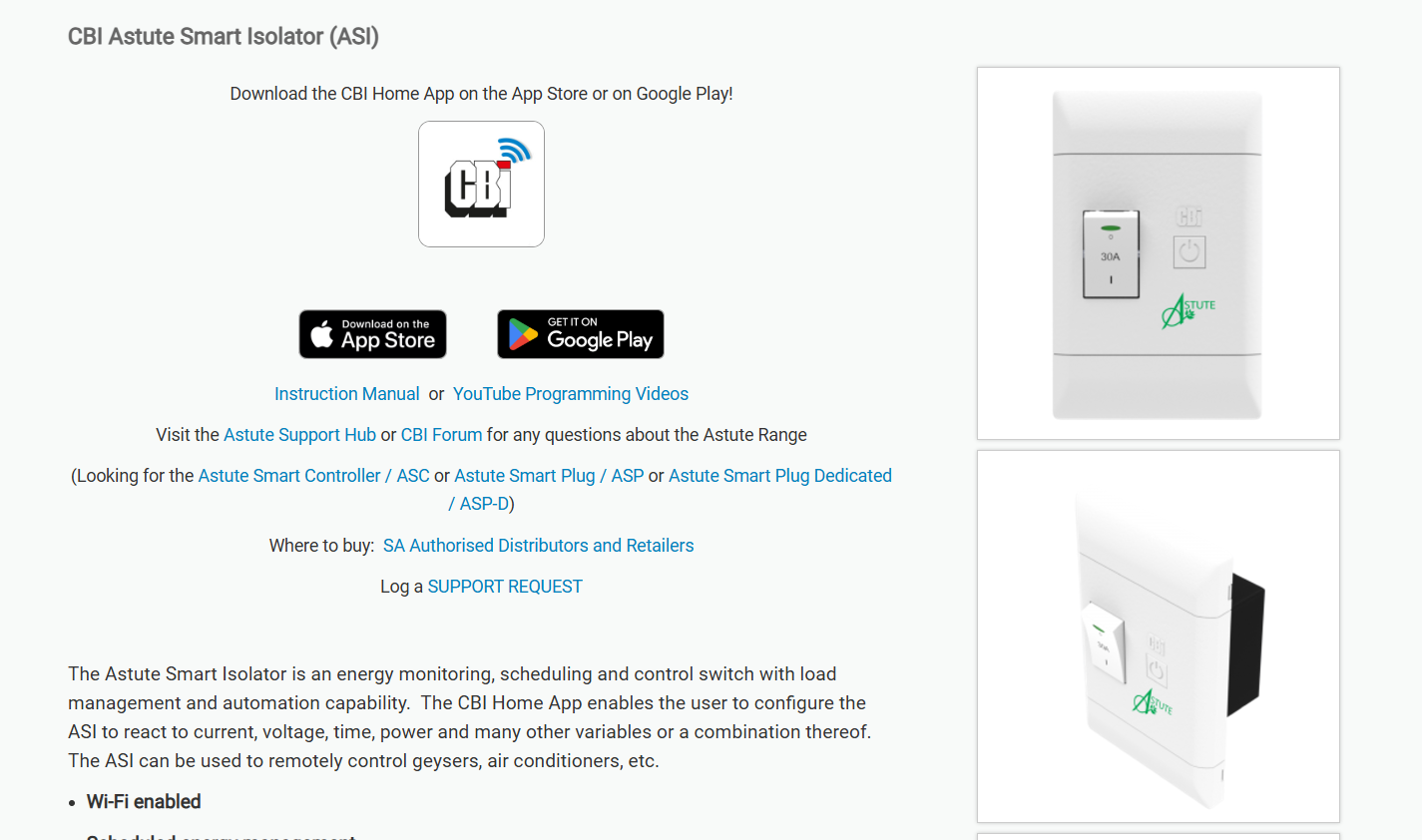

And if there is no space in the DB, use these CBI geyser isolators, allows you to set up a timer as well. Easy install, just replace the Geyser Isolator with below and link to the wifi.

I think many people underestimate how much electricity a pump running 6/8/10 hours a day consume - unless running at an absolute minimum already there might be more savings there than with the geysers. I think some of the MajorTech type timers have a 3kW limit, so if there are 4kW elements that could also be problem.

That’s worth fitting three of the CBI ASI isolators at about R700 each.

I’ve installed one like this, replaced my old isolator. It work perfectly.
