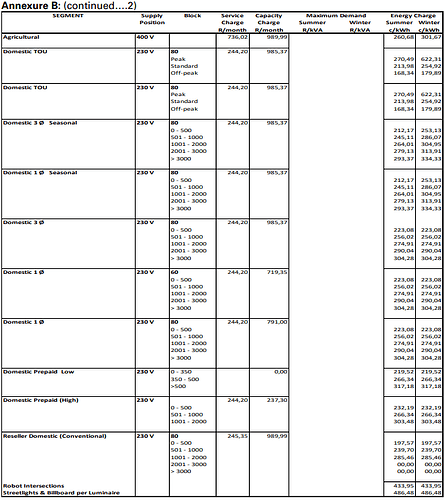

A snip of the full tariff annexure:
Worth noting the Domestic Prepaid (High) now has different blocks and also the service (R244.20 excl) and capacity (R237.30 excl) charges. It used to be 0-350, 350-500 & 500+, but now is 0-500, 500-1000, 1000-2000.
I actually think the 18.84% increase mentioned is either a typo / formula error or has some weird calculation for someone using 600kWh and includes the extra charges, because the increase % table clearly shows a 10.74% increase:

Just to not have to scroll up to the full table here’s the TOU tariffs:
This includes the R244.20 excl Service Charge, but the Capacity Charge goes to R985.37 and then there’s a split between Peak, Standard and Off-peak consumption and a Summer / Winter split where most notably peak usage in summer is 270.49c/kWh (excl), but jumps to 622.31c/kWh (excl) in winter.
This is where the registering with City Power part gets murky for me as I really can’t tell if you can register, not feed back and stay on the prepaid tariff or if you have to go to TOU even if you don’t feed back and/or don’t want to get ‘rewarded’ for feeding back.

Thanks. That’s a nice detailed document. Interestingly they have give a little to the non-indigent pre-paid users by extending the tariff blocks. Currently these are
0-350
351-500
501 →
They change to
0-500
501-1000
1000 →
I apparently have the option to switch to the TOU tariff. I am going to load all of this into a spreadsheet and do some number crunching.

Though they only quote for TOU 80A. Look at the other tariffs and there’s a difference of about R200 a month between 60A (which I have) and 80A.
Make that adjustment and I start saving on TOU, but not by exciting amounts.

True, but the only 60A I see is the Domestic 1 Ø which I think is the normal postpaid. The Domestic TOU does specify “<=80” in the % incrase section which covers the 60A and seems to be the only Domestic TOU rate (for now).
It’s still crazy either way if you are on prepaid currently.
