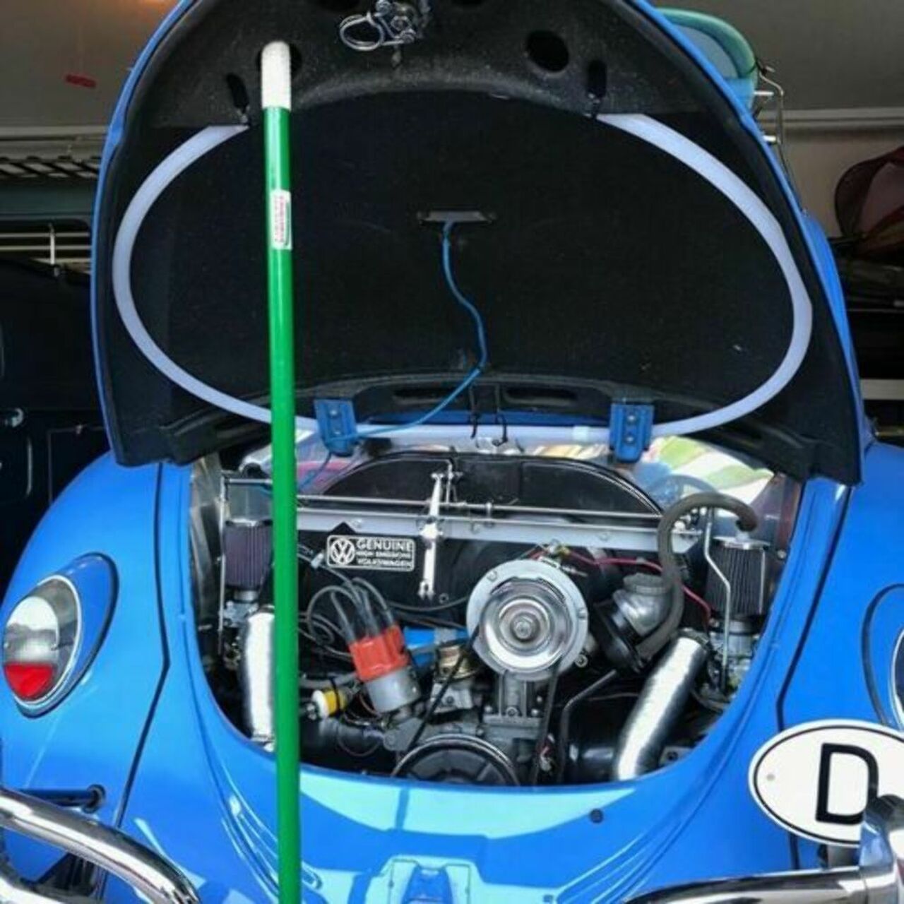

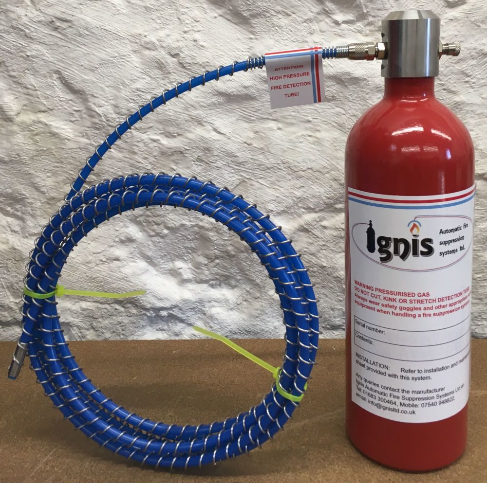

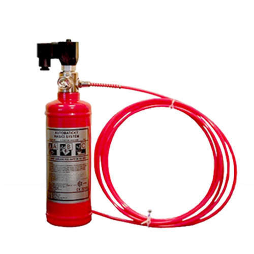

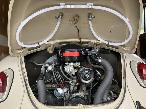

I still want to build a CO2 system for mine and got a loaded Co2 bottle. I have seen a setup where they run small pneumatic pipe in a system that is connect to a CO2 setup. If a fire breaks out close to the pneumatic pipe thatās under pressure, it will burn the pipe and the CO2 will hit that spot where it burns.
You get ones that the guys run in the beetle/komby engine compartment.
You get this ones:
And then you get one they call Blazecut.
