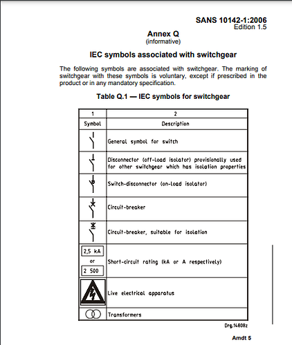

@Tariqe what symbol did you use in your drawing for dc disconnect?

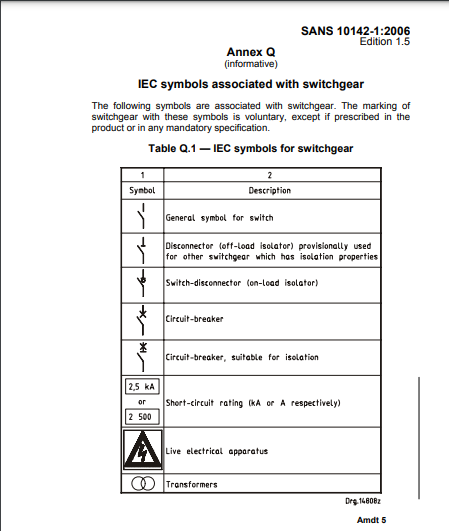

I use qelectrotech. The symbol I used is this one:

i have used the same symbol as the guidelines suggest

Some people are unaware of the MCB symbols differentiating between on/offload isolators and circuit breakers. I standardize on buying circuit breakers suitable for isolation.
So we use IEC electrical symbols…
It is useful to know because even electrical suppliers may not always know and sell you something for the wrong application.

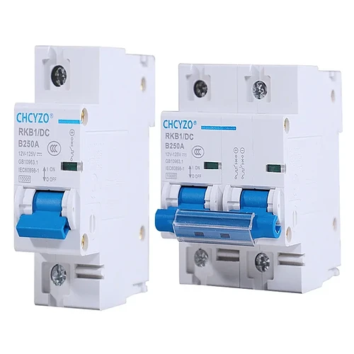

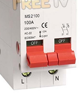

Some circuit breakers are unsuitable for isolation and some isolators are not rated to break load current.
For instance this isn’t an MCB that can be used for isolation:
And this is an isolator not an MCB:
