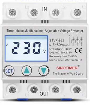

This is cheap and won’t satisfy your needs:
https://www.aliexpress.com/item/32772755043.html?spm=a2g0s.9042311.0.0.27424c4dM2EQVR
Of course there will be things like Ziehls and the like that will probably do it.
I suspect that if you did a bit of searching you’ll find something far more inexpensive with a settable timer.
Edit: Of course you could always cobble together something like this together with an external timer and a contactor.
Edit: You haven’t specified a the current (1ph or 3ph) that must be switched? If it more than 100A, then you probably won’t find an inline device.
Here is one 10 mins adjustable: (Two in series?)

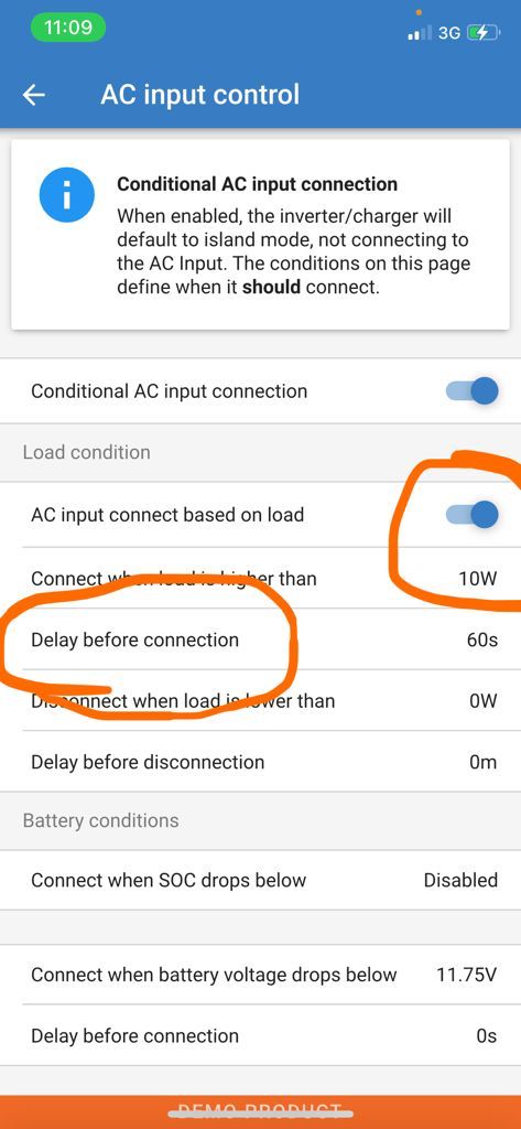

My bad. Victron Quattro and GX device et al
My reference to AC input control was to the new features:
Where it says 60s there upper limit is 254s.
Ah, I missed that. I haven’t used that GUI interface at all. My reference was purely from a VEConfig perspective.
Is there a real world reason for that restriction? Seems strange that the limit is 254 (one less than 255)… maybe it is a limit on the input field’s variable type?
