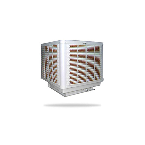

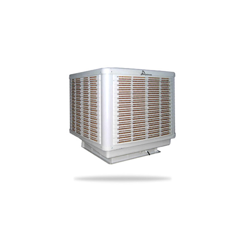

Once you know what to look for, they are actually surprisingly common around here in Gauteng - I see plenty of these on roofs:
Inside the only sound we hear is the bit of air blowing through the vents in the ceiling. It is much more quiet than my 24k BTU split aircon - because there’s no fan inside blowing air around (my AC unit is about 5m away through effectively 2 walls, so that’s not the part we hear).
If I recall correctly, with an evap-cooler you have to have doors open because you’re effectively humidifying the air and thus you want to the high humidity air to “get out”. So it may be even better for a restaurant. But don’t quote me on this.
Of course, they do require water, and because they’re evaporating water, you’re going to likely find that whatever’s in the borehole water will cake onto the panes very quickly. So be prepared to swop those out reguarly. My borehole has seriously hard water, and I can imagine the calcium-carbonate caking up an evap cooler quickly.
There’s also a reason why they’re often called “swamp-coolers” – because if you don’t clean out those panes, they will start smelling like a swamp eventually as bacteria grow in them.
