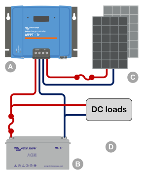

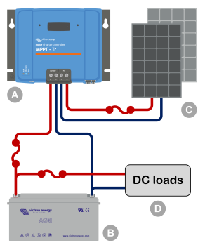

When I installed my SmartSolar MPPT in 2020 there was no mention in the manual of fusing. Since then the manual for the MPPT has been updated to include a requirement for a fuse between the MPPT and battery:
My wiring currently looks like this:
Changing the wiring to the top layout is going to be difficult. Does anyone actually wire their MPPTs like that?
I’m about to do another installation and I don’t want to have to install fuses on both the PV and battery side of the MPPT unless I have no choice. Assuming the cable to the DC loads is rated to carry the sum of the battery and MPPT currents, is there really a need for a fuse on the output side of the MPPT?

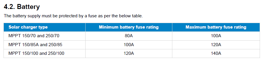

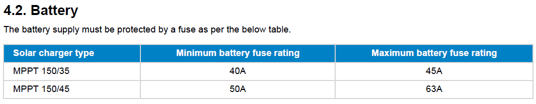

I have no “horse in this race”, nor am I arguing with your view, bar this from Victron manuals …
… as he leaves the building still mulling that he must still do that himself …
EDIT: My 250/85 is fine, the 150/35 are maar thin wires, seeing as fuses are to protect the wires, not the equipment.
