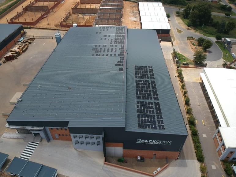

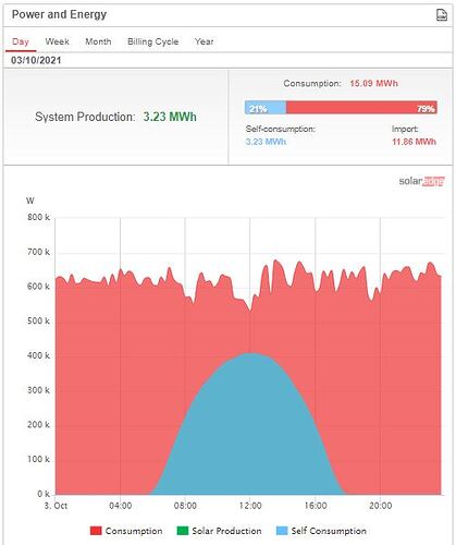

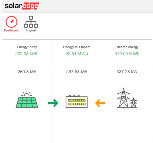

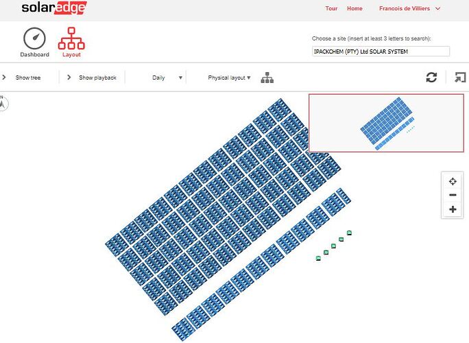

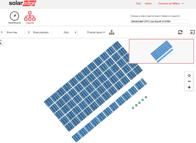

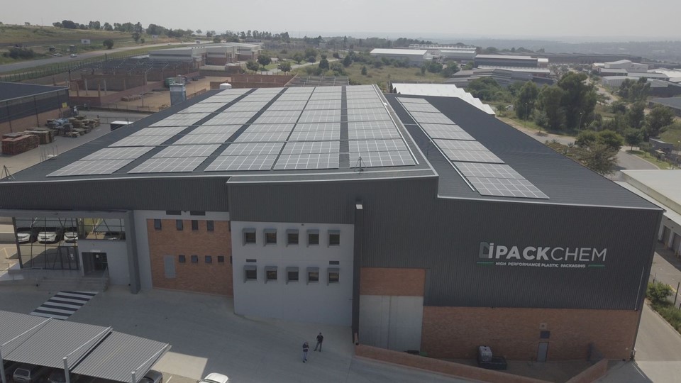

The work system is 502kWp - just over 1400x 350W JA panels feeding 5 x 100kW SolarEdge inverters. We are a specialised blow-moulding company with a fairly stable 600-700kW draw, 24/7. So it was a perfect candidate for a grid-tied solution. See some pictures below (had to go back to 3 October 2021 to find a perfect day’s production with zero cloudcover, loadshedding or interrupted production).
