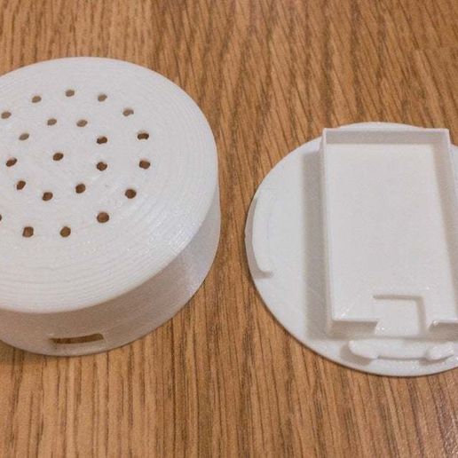

The extractor was fitted to a sonoff mini, to keep the WAF factor up, just like every light in the house, there is a manual switch for the wife, and I use my phone. a d1 mini in the roof with a sonoff temperature and humidity sensor right above the shower, I was lazy and in a hurry, the sonoff sensor comes in a nice enclosure and i didnt need to have one 3D printed for a dht22.
