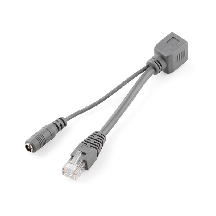

or use a 48v to 24v poe converter. I use these for my older ubiquity wifi access points: 48V to 24V POE Converter 24V 24W POE Splitter for 24V Passive POE MikroTik Accessories Gigabit 802.3af POE to 24V Passive ModeB - AliExpress 30
For 12v, you get the same. You also get PoE splitters, which splits out the power from the network cable to a barrel plug for cameras that doesn’t support PoE. These can do 12v or 5v and you even get ones that split it out as usb-a/b/c to power items that doesn’t support poe. Great to have lots of things running off the PoE switch.

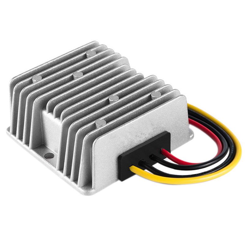

You can use a BUCK / REGULATOR BOOSTER that supplies 48VDC from 12VDC at 6A. This allows you to power a 48VDC POE switch (the ones with the external power brick), which will in turn supply POE power to the LPR. You can then power the UBNT Litebeam of off 24VDC directly from the battery (NB!!! A Litebeam M5 may get damaged when linked via a POE port even is power 4/5 & 7/8 are not present, make sure you use the UP/DOWN Link ports). We use these very often in remote installations and street ANPR installations with back-up power.
If you have a DC supply that provides different voltages (12,24&48V) for your system then try to choose the PSU/battery voltage for the highest load that you have. This simplifies the number and power requirements for the DC-DC converters.
Also conversion from higher to lower voltages (buck) is way easier for the converter electronics than boost converters.
From your response I’m not sure if you agree or disagree with me? Just to clarify, the suggestion is to power POE from 48VDC Switch (via Buck Booster) and power the LB from 24VDC (direct from battery via POE injector)
Using a buck converter with a POE switch makes the installation neater and much more versatile as POE is now available for any IoT, WiFi AP (not talking about UBNT Outdoor) and CCTV.
Weather it is easy or difficult to Buck Boost vs Regulate is irrelevant since it’s a pre manufactured product that is installed.
