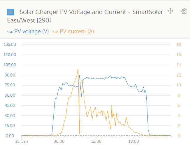

Again this will be very small because as soon as your PV get sun it jumps to it’s design voltage. The current is a ramp up, but not the voltage.
You can see this if you look at the PV Voltage and Current graph.
