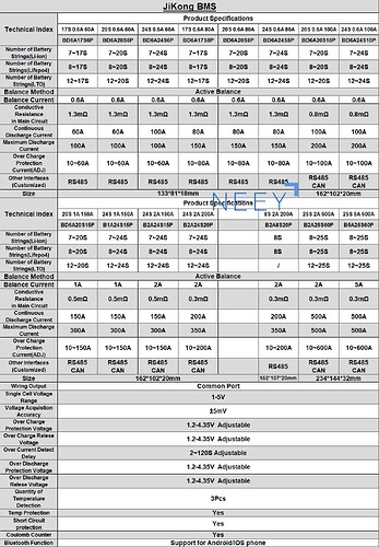

    It is rated continuous at 500A, but I think that is just a shunt and contactor limitation. These are all external so could be potentially exchanged for higher current doodads.
    ( caveat: I don’t know what the app limitations are above 500A- looks like 600A max setting).
    Typically balance leads all have to be the same length, this BMS allows the balance leads to be resistance calibrated. So balance cable wiring management is improved.
Not cheap: JKBMS JIKONG 4A 6A Balansstroom 8S 12S 13S 14S 16S 17S 20S 24S Smart Bms 60A 80A 100A 150A 200A 600A Lifepo4 Li-Ion Batterij - AliExpress 44

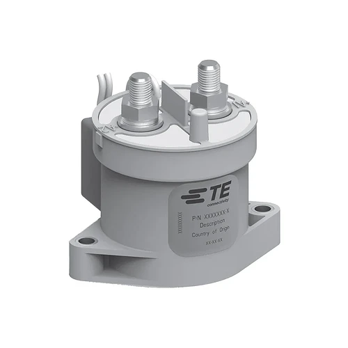

External contactors purchased separately here:

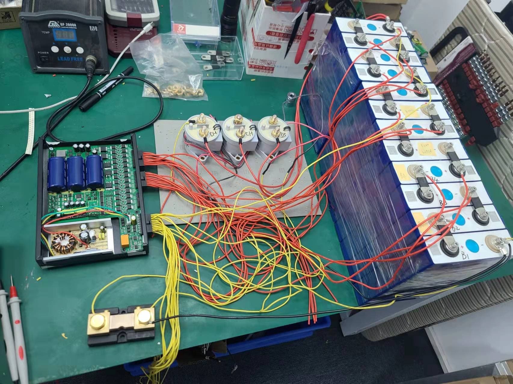

The manufacturer’s bench set up:
( I don’t see why the pre-charge contactor has to be as big as this).

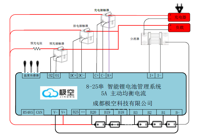

This unfortunately the best circuit diagram I could find:
The 3 suitcase looking things are contactors and the red boxes represent the charger and load respectively.
