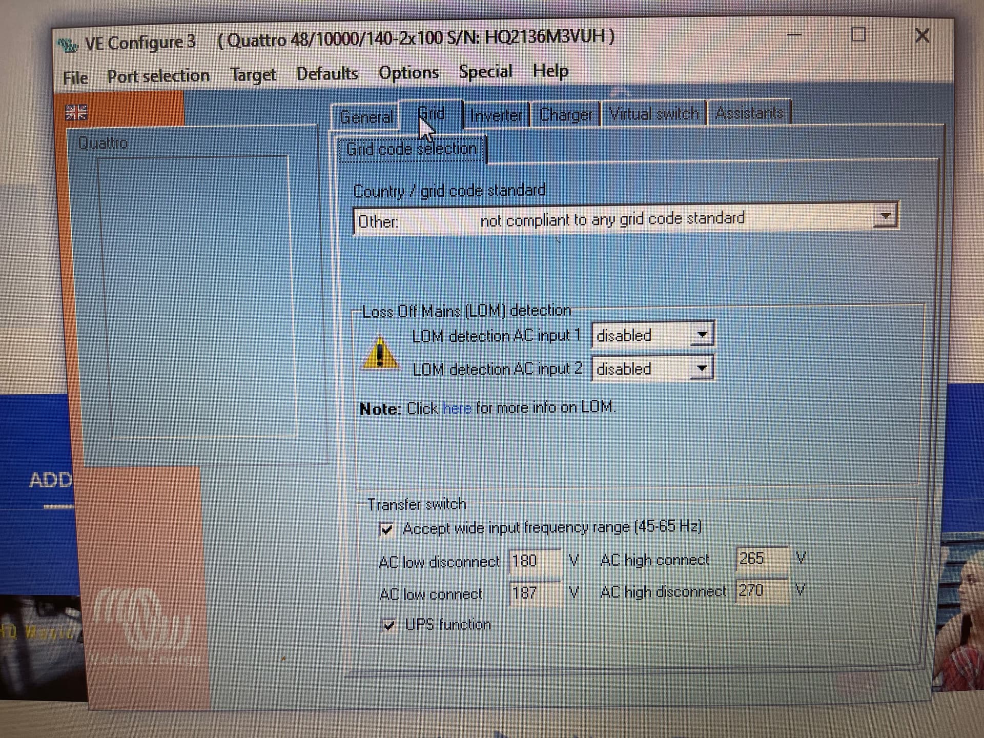

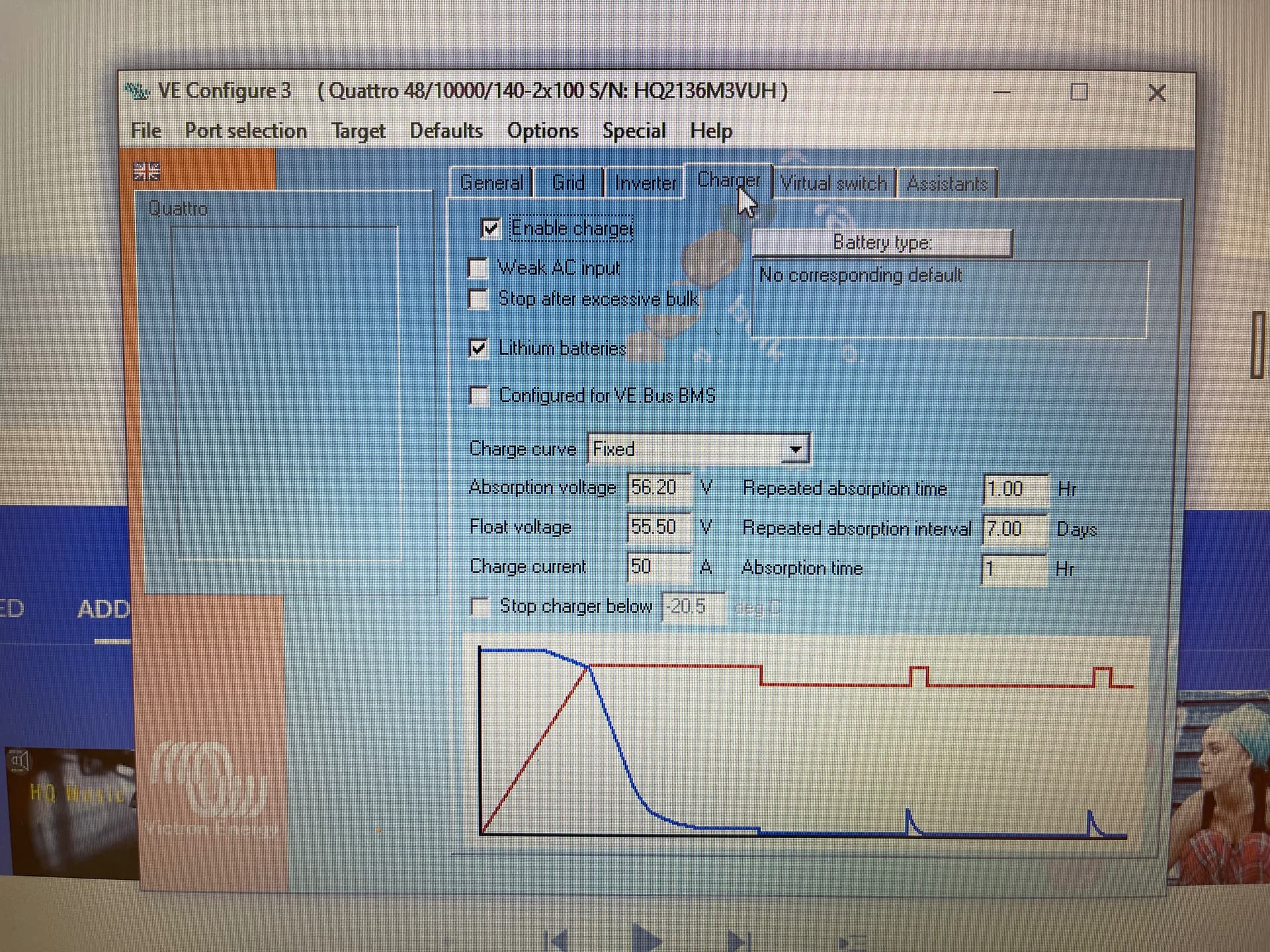

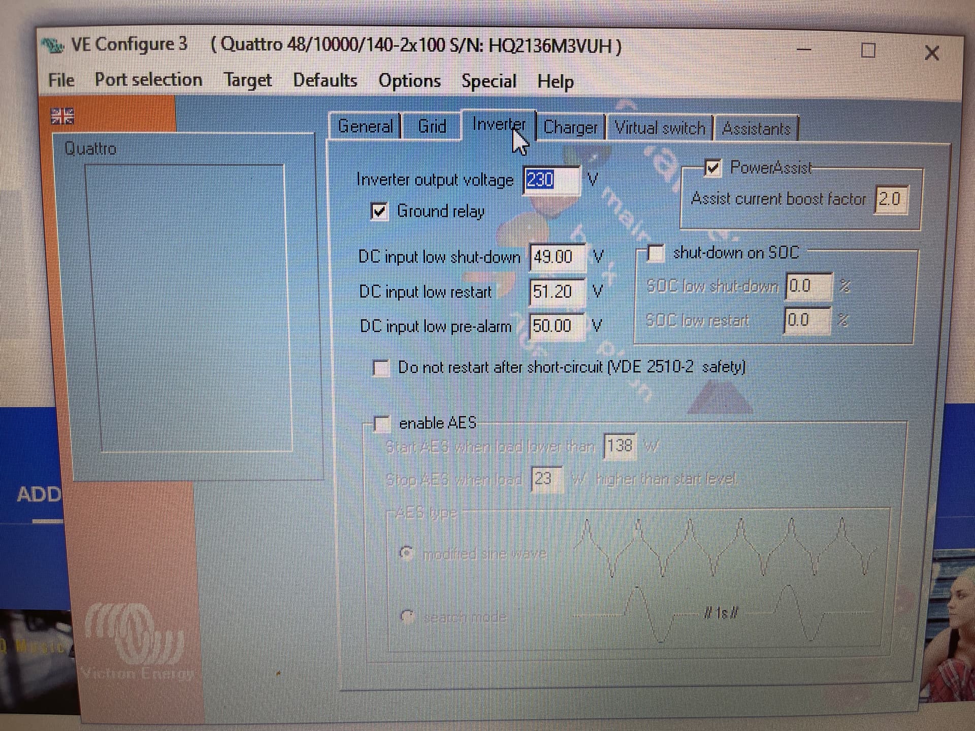

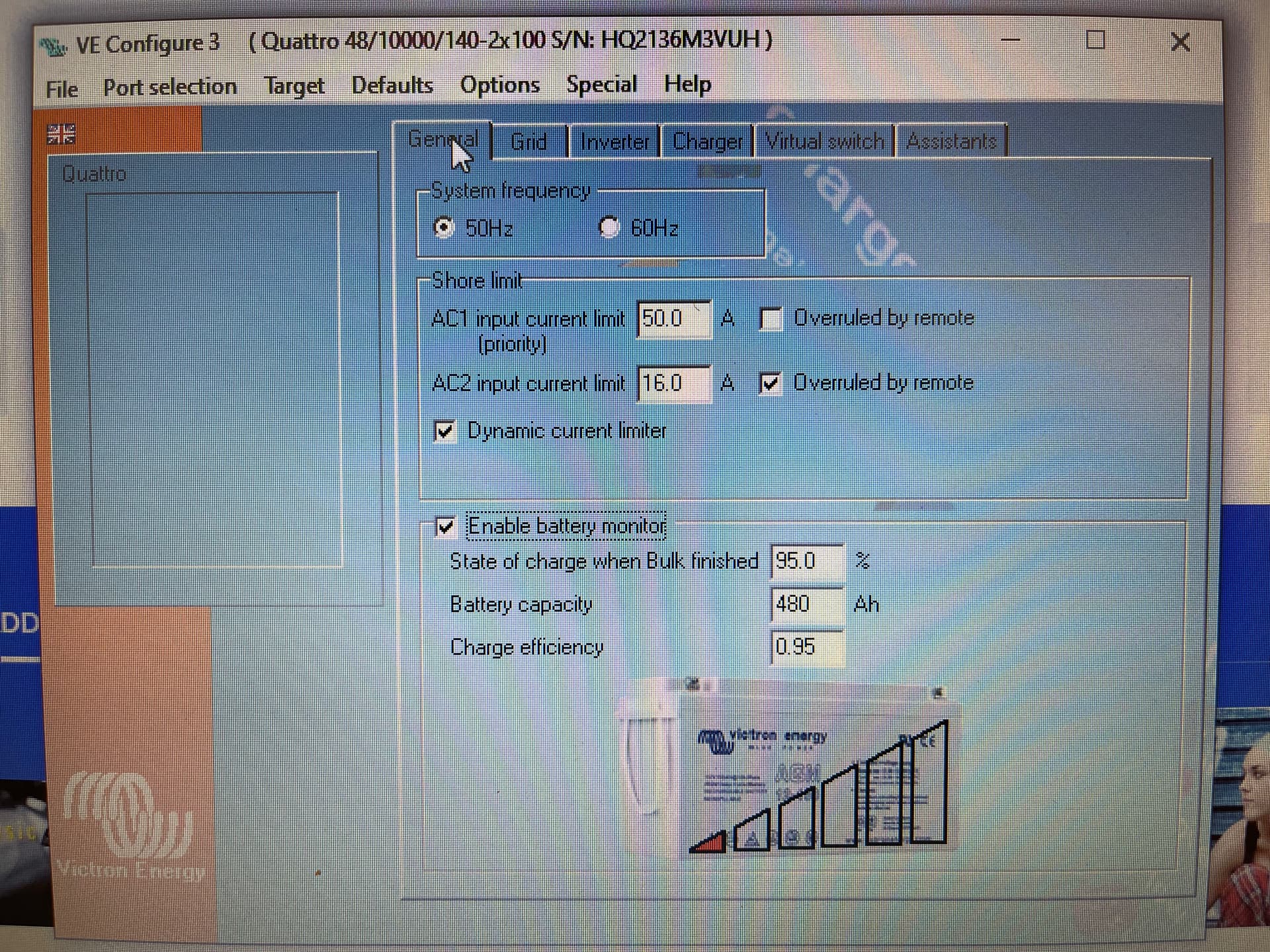

Current setup, but as I said many different combinations already tried.

Enable Weak Ac Input on the charger tab.
Edit : Whoops, seems like you already tried this.
No sweat. I have tried it before but maybe it is a combination of settings that needs to be correct with weak AC one of them?
Yes, weak AC is the only way I have gotten some generators to hook.
You can enable LOM on the AC input that is connected to the grid, keep it disabled with the generator, and enable weak AC, that should do the trick, you can also disable the UPS function.
Nope no joy. Gen charge the batteries but AC out drops to ±100 watts.

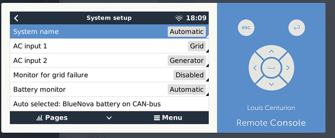

Have you configured the AC Inputs accordingly on the system setup page of the Venus?
