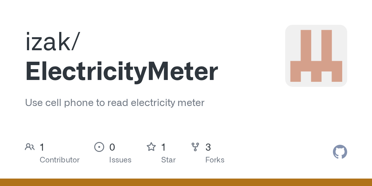

Yeah, I made an Android app (or rather, I fixed one up from someone else… someone who stubbornly refused to answer my emails when I asked if it was okay :slight_smile:) that uses the camera of the device to count the LED blinks and calculate it for you. I went as far as making the app keep the phone alive, with the idea of later adding some logging to it. You could then, in theory, mount an old phone to your prepaid meter to do a bit of logging.
Shortly afterwards I discovered that my conlog meter has a feature: Type #1# on the keypad, and it shows you the current consumption on the LCD. Lost interest in the Android app after that.
Someone contacted me once and asked if they can use the app for some project in their country. I said yes, but ask the original author. CCed him in the mail. Still no response. I’m pretty sure he intended the code to be public domain (since he put it up for download without an explicit license), so… here it is. It is positively ancient by now :slight_smile:

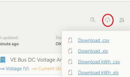

Why not just download the data from VRM…
With a bit of trickery, it should be simple enough to figure out what http request you need to pull that using a script…
