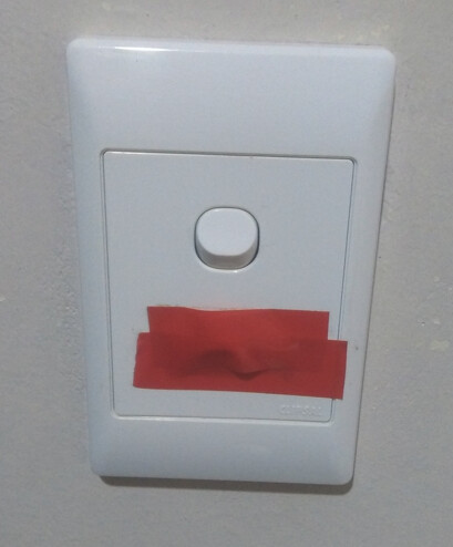

I saw this, coupled with what Sarel said about rewiring, it reminded me of what I did on a switch or two, muscle memory “be-gone” … :laughing:
Hahaha I have resorted to that as well, but with very tough good quality clear transparent sellotape. Family learned quickly the switch she don’t move no more :rofl:
Also, in my mind, I can use my time better than fishing for neutrals or opening switch wall boxes, but meh, thats just me :unamused: plug the light in, tape the switch, done :white_check_mark: To lazy for all that work….
Family now mostly trained….

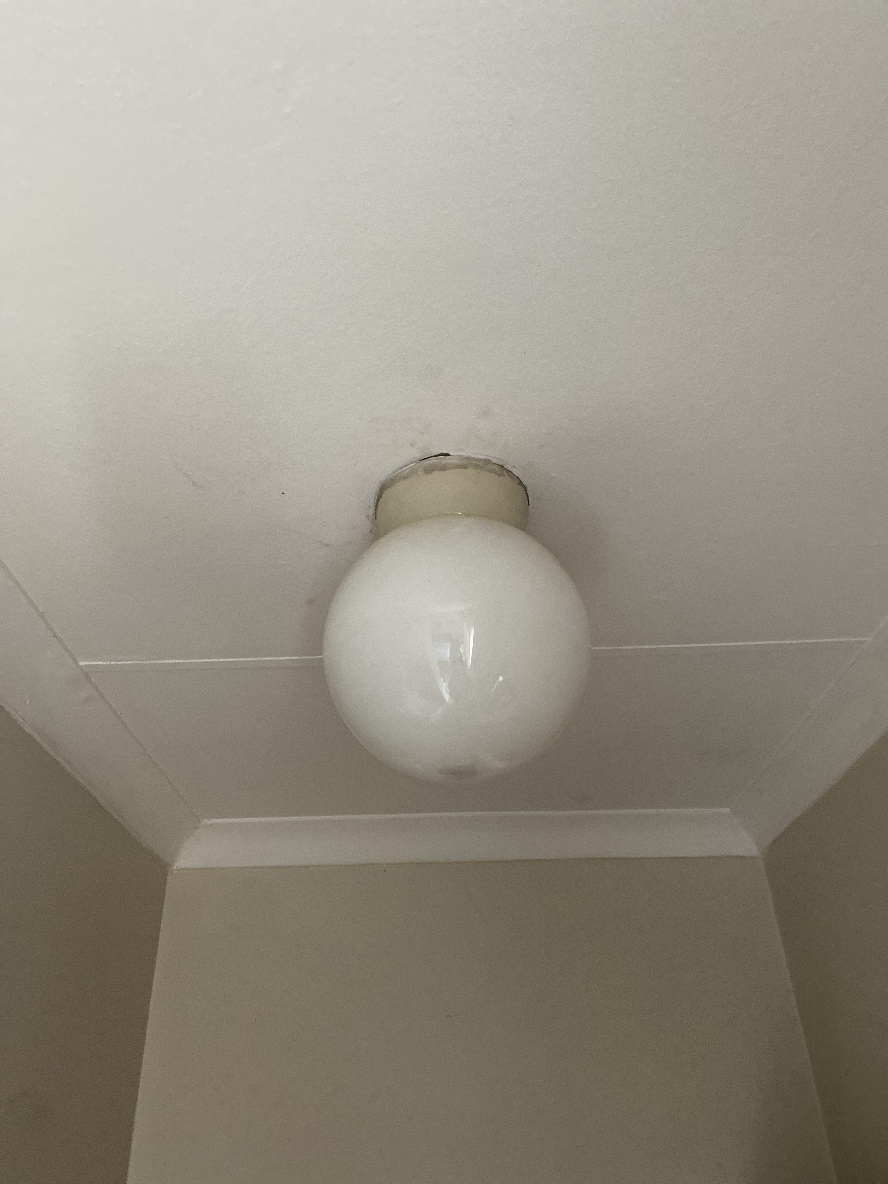

I typically pull neutrals when I change the light fittings - the house came with mostly those “lovely old glass crystal balls” so we’ve been slowly but surely replacing them with more modern fittings. Luckily the opaque white ones and not those aged yellow ones!!

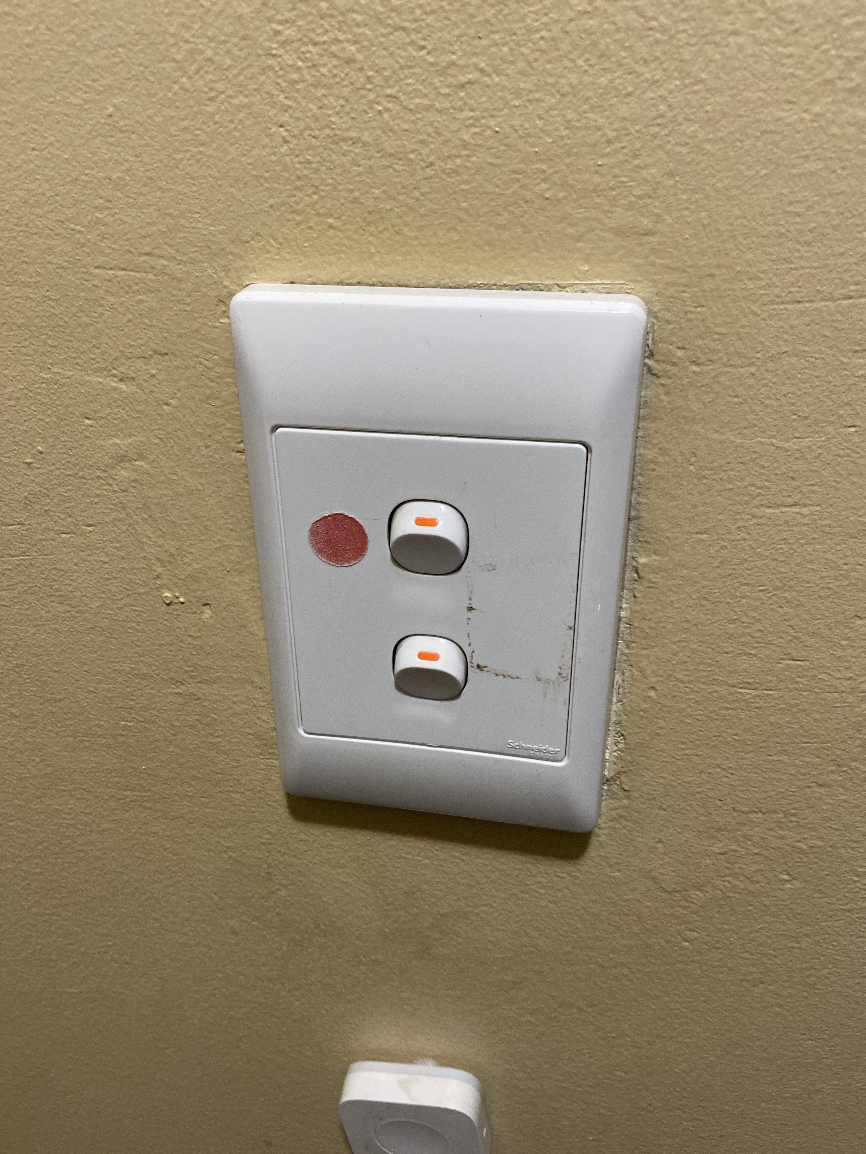

I tried the same, until that “My pfok Marelize …” moment.
Hauled out the red, not black, not see-through, red tape and with me, grumbling "Go ahead now, I dare ya … "
It worked, so I left it.

At my in laws, that thing slowly unscrewed itself over what must have been years. Then my son, who must have been about 7 at the time, went to the toilet and slammed the door a little too hard… and it came down on top of him. Shattered, glass everywhere. Hysterical kid. Door very hard to open since the floor is full of glass shards and it is not the largest room to start with…
Thankfully no blood.
A replacement was found soon after. It was plastic… of course.
