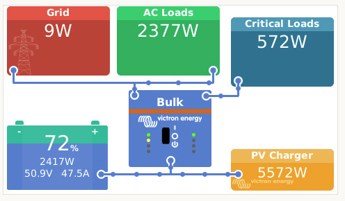

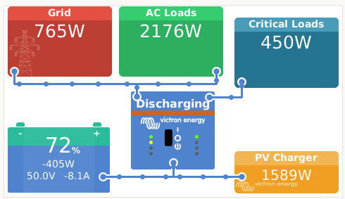

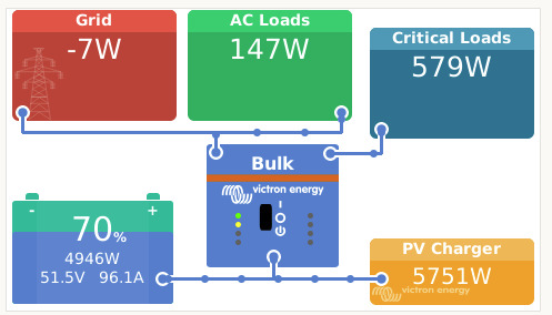

The house when we are working:
Then the 2kw geyser is switched on, manually, via the Tuya App GW display.
I want to automate that with NodeRED, the “manual” part, using a Shelly, and a changeover switch to switch the geyser to critical loads when Eskom is LS, but the costs are interesting, and then the CoC on top of that.
Then some clouds come over, and inverter max watts are pulled back to the panel’s max, which is also in NodeRED, so to cater to this scenario, as clouds move over, if in like Cpt, one needs to switch off the geyser again at this time, as LS is a big consideration, supersedes heating the geyser, as batts are damn expensive to charge on Eskom for multiple LS events coming vs heating the geyser once just enough for a shower.
