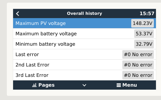

Maybe slightly of topic. Is it possible to get a report on your MPPT’s that shows the max volts they reached since first put into operation?
I’m considering rewiring my strings from 2S3P to 3S2P but would want some comfort. Will also mean less cabling.
For Victron it’s in the console history.
That is EXACTLY what I’m contemplating … from 4S3P to 5S3P … I have 3 more spares.
Seems my volt max sits at 188.87v. (Thanks, @mmaritz, for that reminder!)
So max on the MPPT shows 188.87v / 4 = 47.2175v per panel.
So, 5 x 47.2175v = 236.0875v - far removed from the 250v max.
My 150 is hitting 142.27v - I think will leave it as is. :slight_smile:

I cannot find this sub menu. Under what menu is this? Sorry, internet is really slow today and it takes ages to select something on VRM.
Edit: I found it thank you very much.
So I have on MPPT (1) a max of 119.23V ever reached, and on MPPT (2) a max of 111,6V.
This is on 415W panels with a VOC of 37.32V and at max power 31,45V
So I guess I would be ok to do 3 panels in series. If going by MPPT (1), that would put me at VOC 111,96 which is miles away from 150. And this is over a 2 year period more or less.
