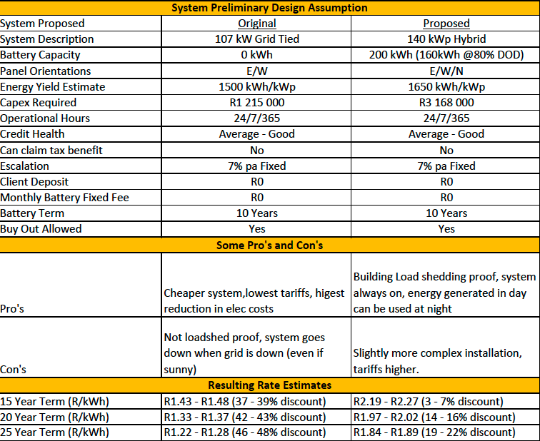

How does this look?
My first question would be why is option 1 not loadshedding proof in the sun
Other than that, the 15 year option 1 does not look to bad. What do you think?

I’ll start off with the aim, that’s to lower our power bill. In the BC we do not have the expertise to know where to start. Had a couple of companies over to give quotes. Been looking at a PPA because there’s no upfront cost options.
Some stats, the building consumption peak was in August at an average of 2300kwh/day. And a low of 900kwh/day in January.

I support @Phil.g00 but in short… Option 1 will switch off during load shedding as it’s Pure Grid Tied (ie no battery backup). It’s designed that way.

With that energy requirement (and IF cost reduction is your goal), you need many more panels than quoted and a grid-tied system. Probably 3x or 4x the panels.

Oh hat, I got this wrong. That’s the total consumption. Which is not what we are trying to cover.
Owners/tenants understand the struggle of LS. The aim is not to keep any units power on. It is to feed the hungry heat pumps when we can. They are 3 x 50kw. So the total we aiming at is 150kw. That’s why the proposed system is 100kw and 140kw.
