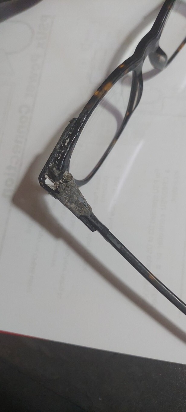

as i am not in the form-league but in the function-team [it took too long…] small stuff which breaks has to be fixed for function purposes and not cosmetic appearance; with that said i had to fix the frame of my glasses which had again broken off at the hinge, the 1st fix with a cut piece of cable tie and superglue did not stand up so i resolved in the following manner:
i made a little frame around the hinge area with sello tape, filled it with some diatomaceous earth [think of it as silica powder - cigarette or other ash will also do] and poured in a few drops of super glue [Cyanoacrylate] and mixed/stirred it with a toothpick. a couple of seconds later the paste was hard as stone and i peeled of the tape - fixed!
thought i share this as even some flat surfaces glued with super-glue tend to come apart.

Basically, a DIY version of Q-Bond.
Bicarbonate of soda works very well too.
Anything alkaline will make superglue set, while anything acidic will prevent it from setting.

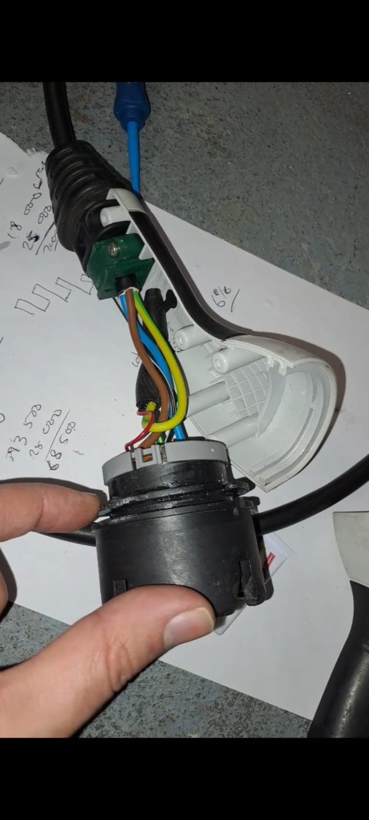

Here is an example of something I repaired with Q-bond. That little ridge that my index finger is on fits into the corresponding groove in the handle. That broke off. And that plug is over R1000, and replacing the whole cable would be more than 7k. Repairing was the cost of the glue and some time.
Edit: And if you wonder what is going on in the background on that random bit of paper, I was explaining interest on loans to my son, for school. Interest takes the amount up, but then you pay some of it off, and then you get a downwards trending square wave like that.
