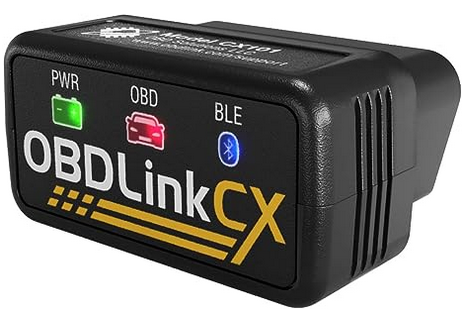

OBD. On-Board Diagnostics. Your car is about the age where an OBD port (or OBD1 as it is called now) may not be out of place. 90s Corollas had them too. You insert a wire into the right pins, and the fault codes are read by counting how many times the check engine light flashes. You do get tools to read them directly if you want.
On that topic, I got myself one of these:
This is a proper one, not the cheap ELM27 knock-offs you get on Ali and other places. Comes with an app on the phone, but you also get special apps for BMW called BimmerLink (for diagnostics) and BimmerCode (for changing settings, like turning off some warnings or making some things default). This is a wonderful bit of kit to have. You can just keep it in the glove box in case you need it.
I can tell you though, that in all the years, the biggest waste of time has been to plug an OBD2 reader into a Toyota. It never has anything to report…
Although, my Brother in law’s car had a misfire and it raised a code for that, which helped us find out which coil pack was gone. Turns out that when he asked the mechanic to replace all 4… the mechanic didn’t do that. One of the old ones was put back… and the cause of the problem.
Yeah, at the time, I googled a lot, case of beer, read ego, is a strong motivator … found them all over cars as you say, going pre-2000.
In the end, I gathered that in lieu of such a “check engine” light, it may be a very strong hint that there is maybe also no ODB port either.:slight_smile:
That is after checking each and every spot some have found, to their surprise, “vintage” ODB ports.
