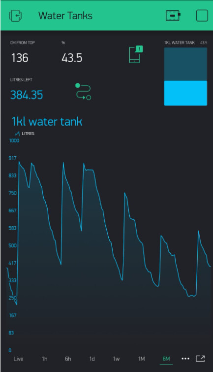

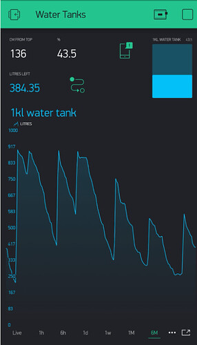

I use an NodeMCU and HC-SR04 to monitor my water tanks, atm all data is send to Blynk.IO but busy setup home assistant to better automate things. My main tank is not connected to anything other than RO waste water, i have another tank that I use to collect rain water, then pump from there to the main tank when needed(see the up spikes)
The SR04 is not water tight, but I added it with the node inside a water tight case and silicone where the ultrasonic sensors comes out, then put that on top of the tank with two small holes through the lid. The one has run over a year the other one about 6 months, even with water condensation they still work and are around R30 if i need to replace them.
so in short you can use the arduino to send what ever signal/short/data to your other systems to operate what you need to with some trial and error.

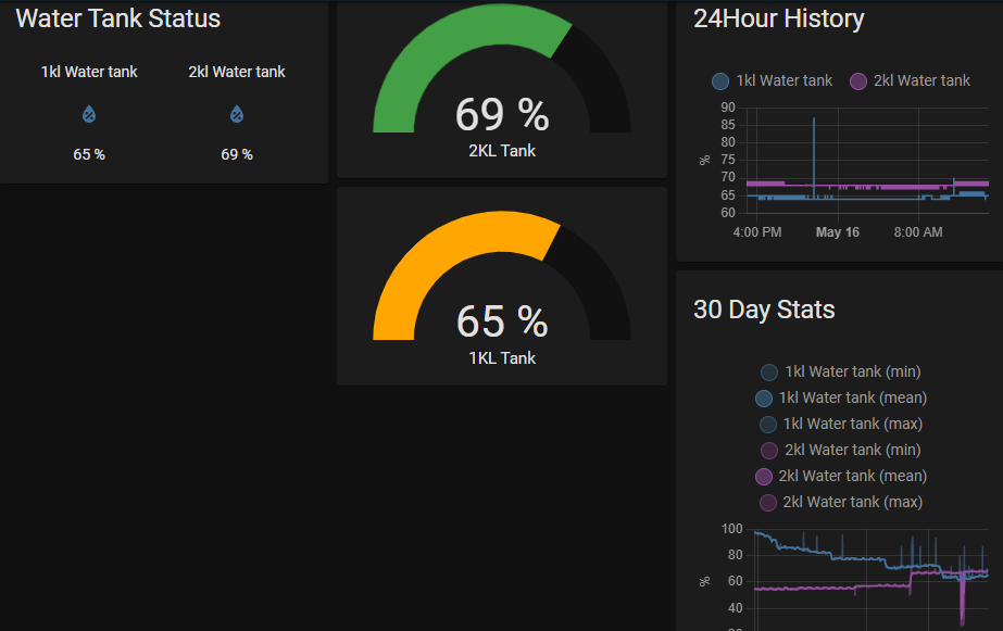

moved over from blynk to HA, still to do a few things but see % wise atm
just remember you need a voltage divider on the one pin as the sensor is 5v and not 3.3
