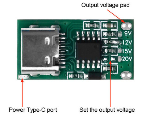

So this unit will auto select the correct voltage for your gizmo??
Yup. Unit powers up at 5V, 500mA, then communicates the preferred power requirements. If the charger can meet those requirements, then it ramps up to that setting.
I have a selection of boards like this:
To use USB charger as a general power supply.
