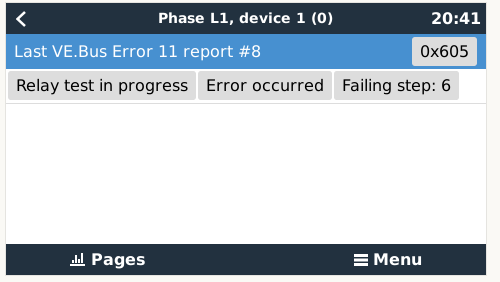

Sooooo, little awkward I plugged in a lead light I use in the garage today and as I did the power went off completely and the garage breaker had tripped.
Inverter (multigrid 3000VA) was making a few clicking sounds like when it reconnects to the grid however was giving error VE.Bus Error 11 failing step 6 then repeated. Zero power being passed though or inverted.
Error lights Float light on and then alternating between bulk and inverter on (VE.Bus Error 11 relay test fault according to the Victron app
If I turn off the mains in then it goes into inverting mode and seems to work 100%, if I switch on then it repeats…
Current error (not it reads #8 was 231 earlier
Little bit of history I believe this is 2nd had inverter (Installer gave it at a discount) and I noted it had the same error (as the ve buss saves last error) Error 11 report #200 failed step 6 0x605 do you think its related, been in flawless service for 3-4 months now
Any hope?

Thanks TTT, I am sure they can repair it its the cost and down time that concern me most (or actually the replacement cost)
Have done a few test my side, bypassed the surge arrestors for what its worth, various voltage checks all check out.
Your relay test is failing.
There are 4 relays in there. The Multi opens and closes them in various combinations, and measures the voltages to make sure they are where they should be.
As an example of what is going on: On the inside it has two pairs of relays, as required for anti-islanding. It closes them individually (only live, only neutral) and makes sure there is no measurable voltage on the other side, then closes them in pairs making sure the voltage is correct. For this to work, the Multi must also be properly earthed itself.
Failing step 8 usually means you have live and neutral swapped around. Other causes for a relay fail is 1) your neutral is floating, 2) your neutral is bonded to earth on the output, 3) Your neutral is NOT bonded to earth on the input side, 4) you have a broken earth (aka floating), 5) you have lost neutral, 6) Input voltage less than 170V, 7) really old firmware (something before 465 or thereabouts if I recall).
