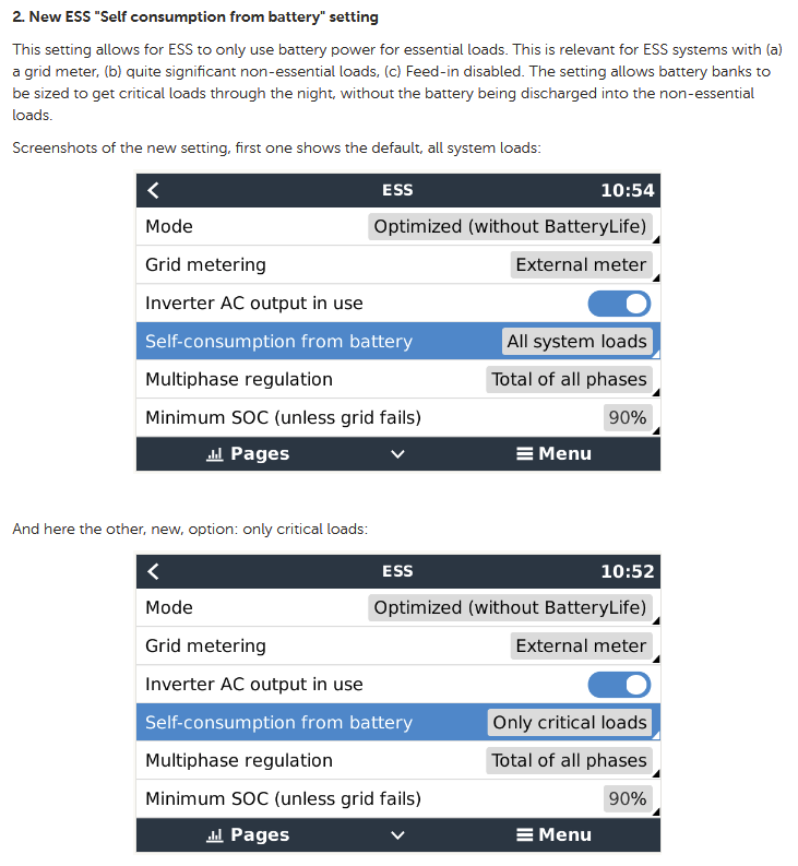

I think I know what this does, but I couldn’t really be definitive from the write-up.
Can someone lay it out for me in practical terms?
@Phil.g00
The changes are still in Dev but are outlined here: https://community.victronenergy.com/questions/222415/venus-os-v31022-available-for-testing.html
Yes, like I said I read that.
Are we talking about “AC2 out” tripping at a pre-determined SOC whilst the grid is still present?
Or, are we talking about not assisting loads upstream of the inverter, but downstream of the meter?
Whatever way, does it pre-suppose a certain way of segregating essential and non-essential loads?

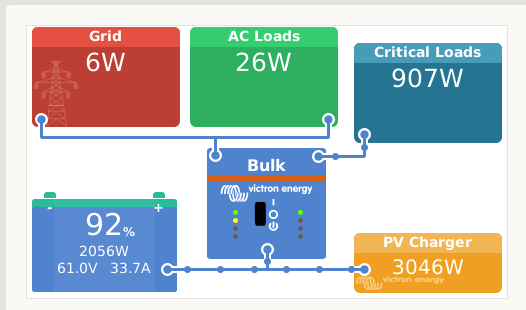

The pic, powering only the Critical loads from batteries and not AC Loads too.
Brilliant move for i.e. smaller batteries, or don’t want to use the batteries to heat a geyser on AC Loads using the batts for example.
Need to have a Carlo Gevazzi OR running with AC-Out_2 wired to non-Critical loads.
So how does it work exactly?
Does it ditch AC out 2?
Does it stop the battery from assisting upstream loads at specific SOC?
Or both?
Or are you guessing like me?
All it does is it limits the amount of power fed to the loads on the input side to only that which is available from PV. The battery is only discharged for critical loads.
The main reason is that if the 3kW geyser turns on at 11PM… you don’t want the battery to be discharged for that. But if there is 2kW of PV at noon, you want that to be fed to the geyser.

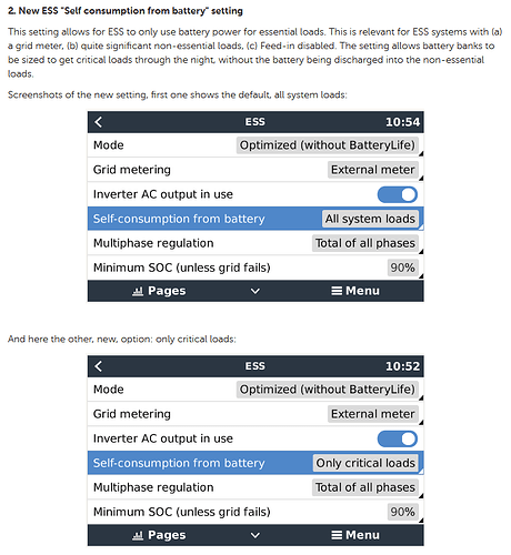

With this option set to “All system loads”, the default, it works as it always has. It will take power out of the battery to power anything anywhere in your setup (even on the input side), because it wants to save you the most money possible and make the grid import as low as possible.
With the option set to “Only critical loads”, it will only take energy out of the battery for loads on the output side. But if there is PV available, it will gladly allow the PV to power loads that are not critical.
The really short answer is: This ensures that we don’t use the battery to heat your geyser in the evening, but we do use the PV to heat it during the day.
