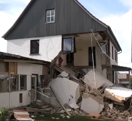

Came across a number of articles and other forums posting about a possible LiFePO4 battery related explosion (in Germany).
The click baity part…
(pic source)
more images
In short, allegedly a 30KWh battery consisting of 3 (2 older and one more recently purchased 200Ah LiFePO4 batteries) might have played a role in an explosive event that lead to the partial collapse of a residential building. While it is somewhat interesting to speculate on what happened and even IF the batteries played any role, something else entirely caught my attention in the home owner being quoted as saying:
“I was in the living room at 1:57 p.m., lying on the sofa to relax,” … “The smoke alarm sounded, I saw smoke coming out of the basement and alerted my colleagues from the fire department,” … He then sent a WhatsApp message to his wife, who was at work late that day. When he wanted to leave the house from the kitchen and wait for the fire brigade, the explosion occurred, making the house uninhabitable
(*emphasis my own)

Wow, the newspaper article says this:
Einzelne Teile des Hauses wurden durch die Explosion bis auf die Straße geschläudert
Some parts of the house were thrown onto the street by the explosion.
There is really not enough facts known, and likely may never be known in this case, to conclusively prove the batteries were involved. The home owner however is an electrician and volunteer firefighter and seems to consider the batteries as being involved (no idea as to his competency).

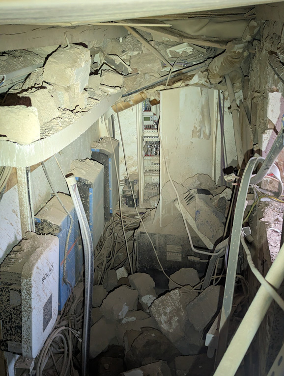

In the German case, an old property listing indicates a basement of about 80m2 but having 2 smaller rooms (pic of the inverter room suggests possibly one of these smaller spaces - compare distance from the multiplusses to the opposite wall with the wndow blown out). There is also mention of an Oil heating system and possibly a boiler (not known if actually present in the same room as the batteries but obviously both potential sources for an explosion themself or at least an ignition source - assuming auto ignition temp was not reached IF a cell started venting during thermal runaway). So, fairly large cells, at least one starts thermal runaway and a cascading release in other cells lead to a build-up of H2 and/or CH,4, in a smaller enclosed space, meets an ignition source… I am sure someone will pop around with the calcs to show you would need cells larger than the contained space to reach the required concentration/ratio to make an explosion feasible - but in theory for me it seems not in the realm of impossibility.

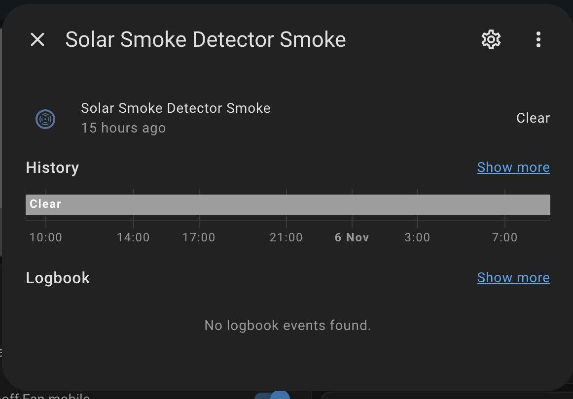

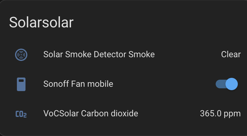

Got one of those nano particle jobbies at my other door about 3 meters away and a big azz industrial CO2 just outside the door. Smoke alarm above the batteries, another one just outside that door about 2 meters away, also on the wifi system.

smoke alarm sends a message using wifi network when triggered?

Yes they do, also the usual waking ya from the dead screams from the unit itself. Also have the WiFi units display in my Home Assistant dashboard.
