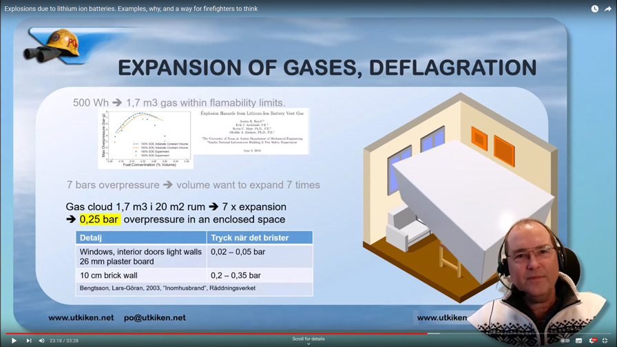

The following is focussed on educating firefighters, is at times somewhat alarmist, mostly deals with examples of EV fires (but from what I gather once thermal runaway has started the chemistry of the cells do not really change the risks).

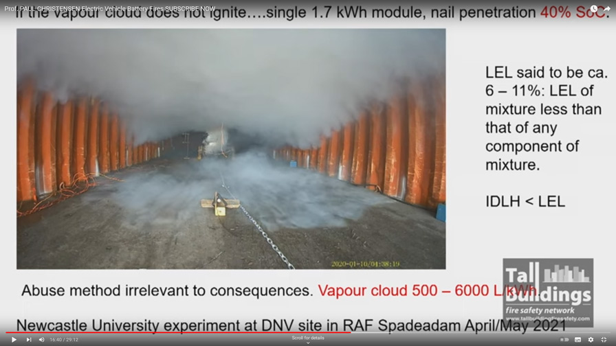

Seeing the rapid development of the vapour layers (which might be confused with smoke) for instance makes me question things like how “navigation” will work with limited visibility. The toxic nature of what is vented (possibly worse with LiFePO4?) is another hazard. The very real danger of a very hot jet of gas being released with a face close to the surface seems another very unpleasant risk.
In short, unless another human life is at stake - vacate (GTFO) and let insurance deal with it ?
