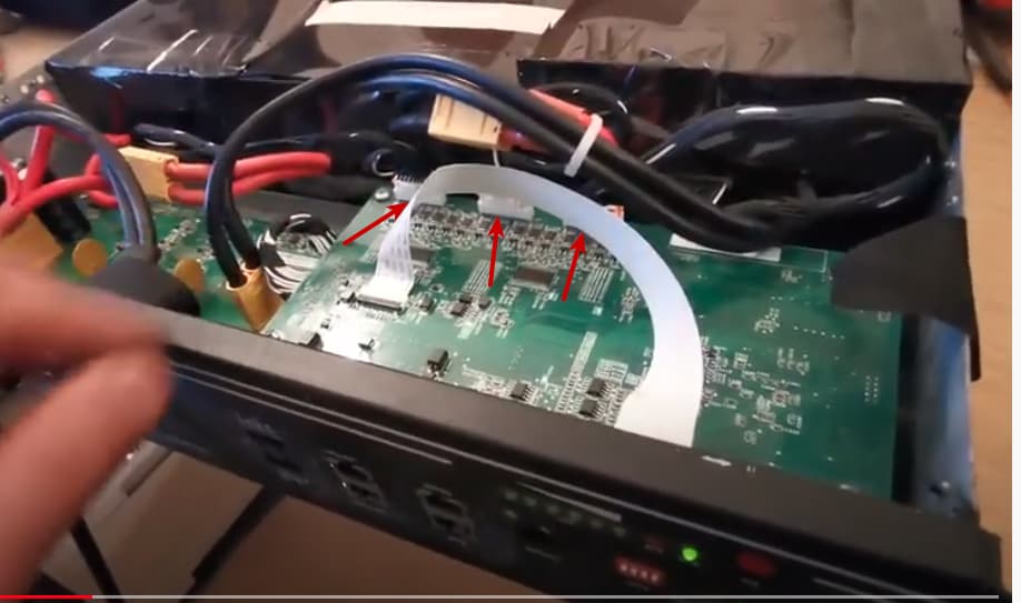

i’ll try to isolate the cell however, do I have to desolder from the pack/pouch? see how they are PYLONTECH eBay solar storage battery teardown faulty repair BMS battery swelling 54v pack - YouTube

According to this video, the terminals are not accessible. You will have to disassemble the packs and reassemble afterwards.
Replying to myself here. If you know what you are doing, you can also unplug the balance wires, and use that to gain access to the individual cells.

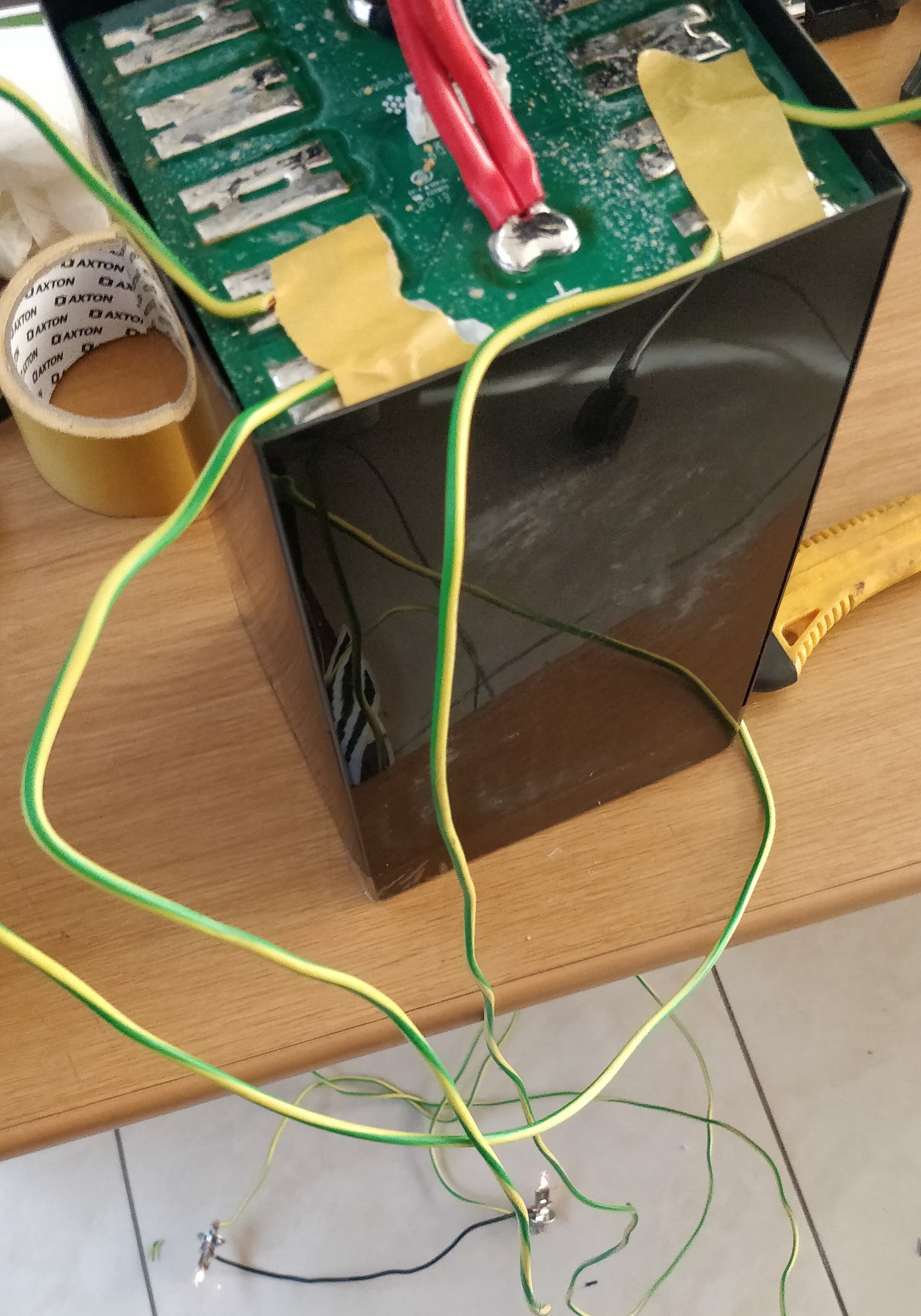

The white wire is the main -ve of the pack while the others are the +ves from cell 1 to 5. using a volt meter with the -ve terminal stationed at the white wire, you’ll read increasing voltage from cell 1 to 5 (they’re in series).
In the video, i saw that he could measure individual cell volts. I’ll find the weak cell’s terminals in the same way, solder a piece of wire each and then clamp this dc adapter to the wires.

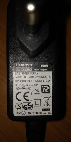

Question is, how long will it take this 3.3v @ 2A adapter to charge the cell from 2.6 to 3.5?
50Ah ÷ 2A = 25hours? I’ll constantly check and see.

I think 2A is too much for that thin wire. But if we assume it is a 50Ah cell, and it is completely empty, then it will take around 25 hours to be completely charged.
I’d still feel safer if it was current limited.

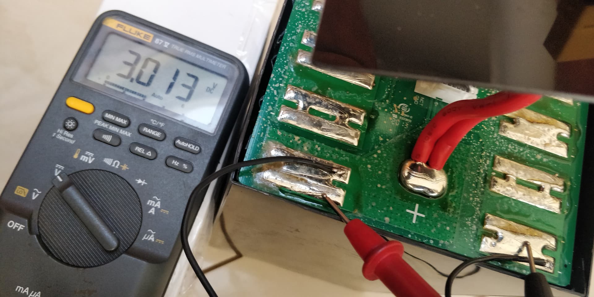

I started yesterday at about 20h30 @ 2.55v and i am now at 3v:

OOooo nice!! A fluke 87V. Nice multimeter. I got the 88V one.

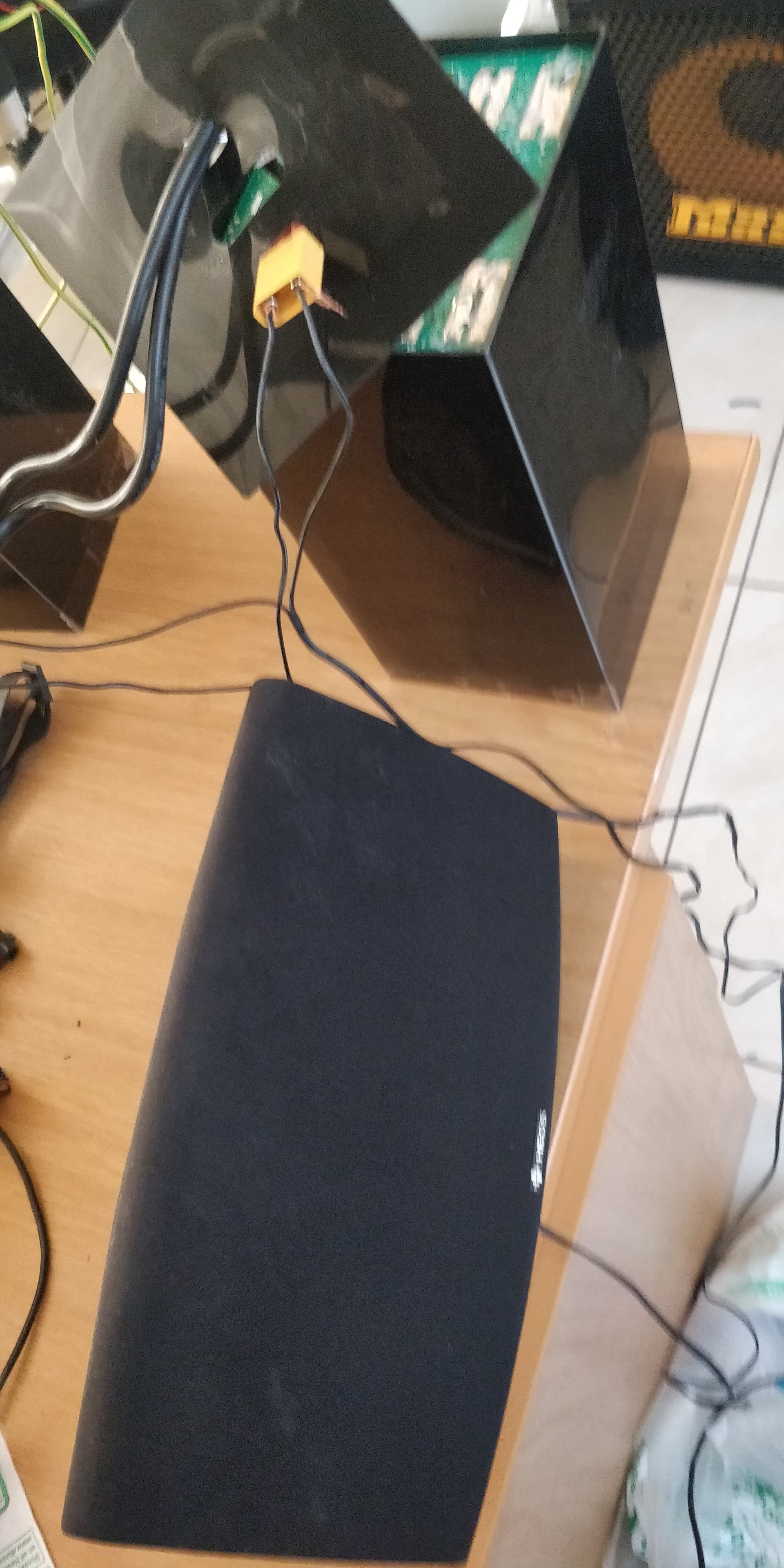

discharging 16v pack with 18v speaker:
discharging individual cells with car 12v bulb:

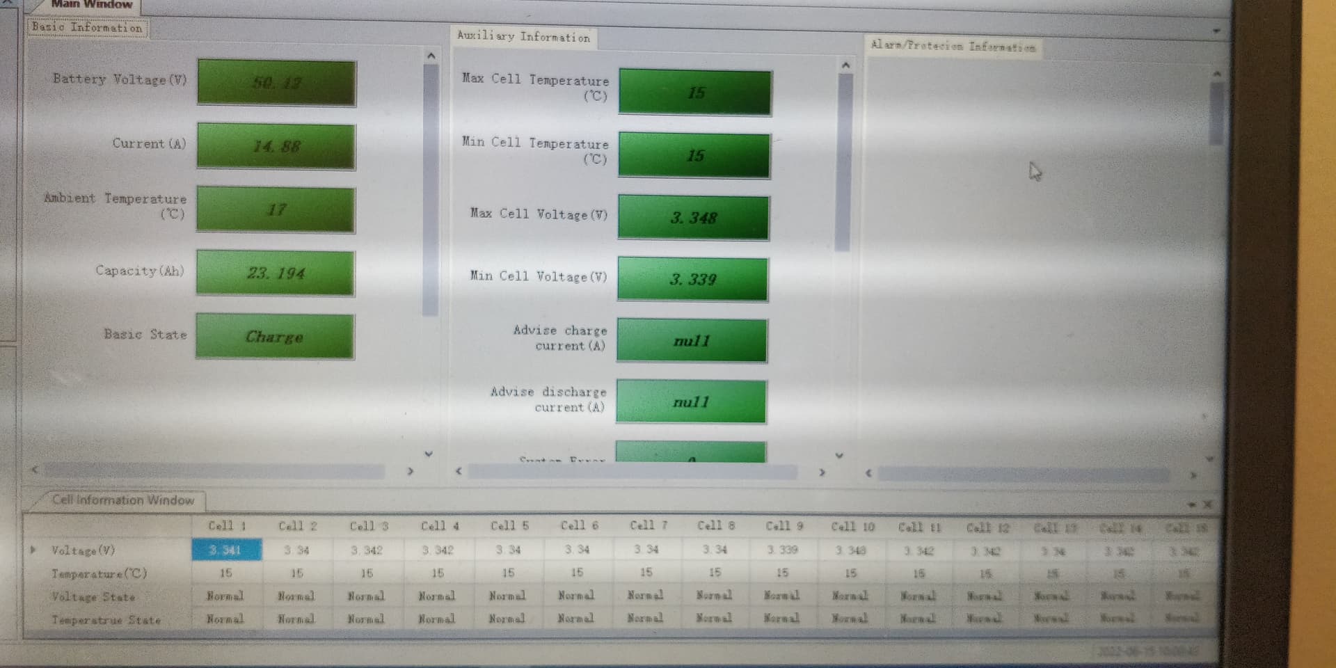

I managed to bring the cells up to 3.6v and observed these:
The one cell that was initially at 2.6V seemed to struggle to hold charge @ 3.6V. So I charged it last and quickly put the everything together and the BMS took over.

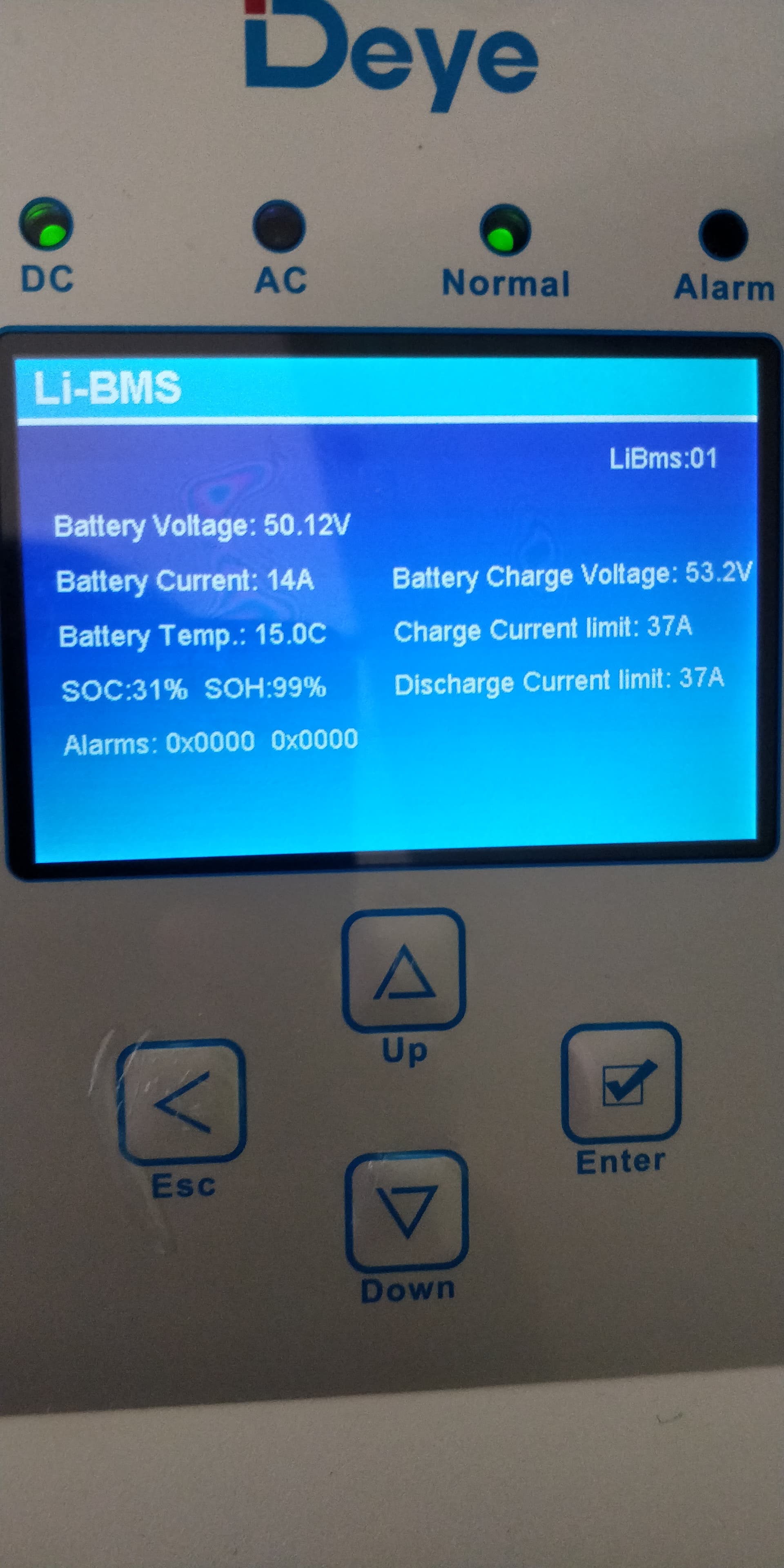

The battery’s max charge limit is 37A but @ 20A I saw some cells charging faster that others. I further dropped the inverter’s charge limit to 10A and noticed some consistency across the cells.
Today is day 2 of use and I am currently charging from @ 15A limit.
So, I hope it’s working
